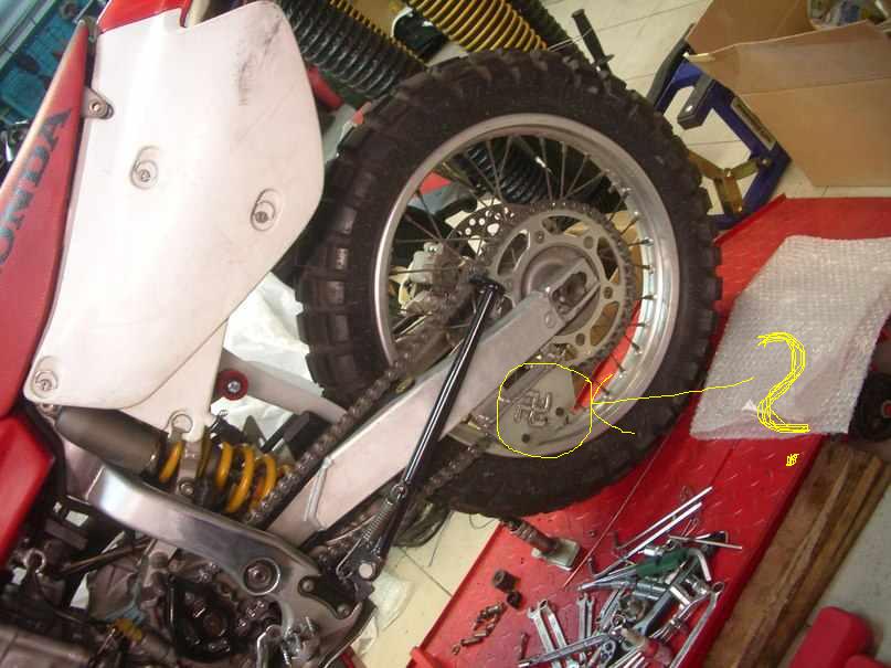

Oil Tank Story or idea transform)
The weld leaked, which changed my opinion about the Oil tank ..and after my brother made comments on it too, I understood that i don't need it and i need a big tool storage. for my small mechanic world)
It was drilled)) For Birth of something new we need to destroy something old..
edge was welded ..
Bending some armor shield)
I've had Many thoughts about cover holder , and now I have a solution. it's quick release fasteners from sport plastic
armor on it
Try on
I though about some ornament to hide the weld
Made a third bracket point
it's almost done..
Also one thing that i made ,was a Led mount. I received RAM mount arm and a mounted ball )
all was made by cut machine, Drill and file..
edges were welded
Kit is done) Mount, ball, bolts and rubber antivibe gasket
Now I can't stop) and go along ! Peace! and thank you for All!

Mikl, I know we discussed the 10.5 kg rear spring but looking back at the build, you might want the 11.0kg, that's the BIG tank. If it's not too late I'd weigh the bike fueled, add your weight with gear and make your springrate decision based on the results.
