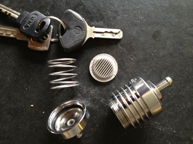

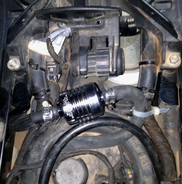

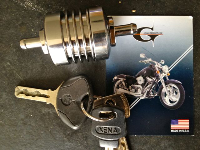

Just installed the new fuel filter. It is a Golan mini with 1/4" barbs. S/S 10 microns.
here installed below the seat
Here the filter with the key for judging the size
and inside:
the filter is S/S and washable

If I would do it again I would buy the Super-mini, it is the same filter in a still smaller housing...
