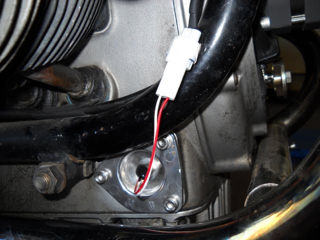

Could you please tell me what is the device bolted into your filter housing cover and what's it's use ?
Thanks.
To the others, gluing the O-ring and shim with grease on the cover is an easy way to get the things done properly and not leaking...
georgesgiralt is offline   Reply With Quote

Ray, Could you please tell me what is the device bolted into your filter housing cover and what's it's use ?
It is a temperature sending unit that came with my Acewell, it can be used for water or oil temp. There are two temp readouts on the Acewell, one for ambient air temp, the other for oil (or water) temp. A few more details starting in post #393 here - http://www.advrider.com/forums/showt...527749&page=27 .
