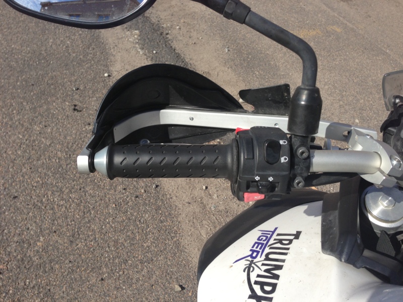

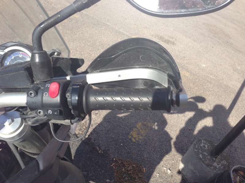

Not a separate thread, no. The install was not complicated. I used the big bar adapter on the throttle side but not on the clutch side; with a little more fiddling, I wouldn't have needed it on the throttle side either. Other people have done it with the regular bar clamp.
When you use the regular bar clamp, you can use the conical spacers at the ends of the bars that are part of the stock handguard installation, as shown here on my left-side handguard. (Also, I had to grind a little material out of the bar clamp to make it fit the bar better; I just used a Dremel.)
With the big-bar adapter on the right, I had to use a couple of thinner spacers to move the whole handguard assembly inboard -- that conical spacer was too wide, and the handguard wasn't long enough to mate with the big-bar adapter with that spacer in place. The thinner spacers I used were the washers used on the outer surface of the stock handguards; I just used them both together. If you put the handguard flush against the bar, it hits the throttle tube and restricts it, so you need to put something in between.

Blacktiger, so if my understanding is right, you are saying that no drilling is required? Just unscrewing the stock bar ends and screwing in the Acerbis bar ends?
Originally Posted by blacktiger View Post
I know you've solved your immediate problem but for future reference those tricky looking ends do unscrew from the bar. There are flats machined into it to get a spanner on. I think the inside diameter is the same as Renthals at 14mm.
TekurRides is offline   Reply With Quote

Old 02-18-2013, 12:05 PM   #627
TekurRides
