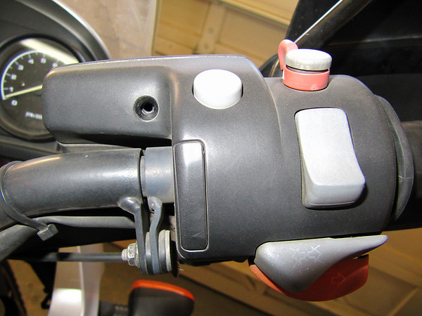

Is there any way to adjust the hand lever angle on these bikes? I want to rotate these up a bit and can't seem to find anything on the topic.

yes:
Remove this cover,
Under it there is a cap screw that clamps the controls in place.
I don't have a picture of that.

Originally Posted by Mr Head View Post
yes:
Remove this cover,
The deed is done. Thanks! MUCH better.
For others, on my 2002 GSA:
Two torx and an allen to loosen the hand guard so it can be positioned out of the way
Three Phillips screws to remove that cover. One on the front, one on the bottom, one behind the mirror stem (much smaller than the other two). Remove the mirror stem with an Allen from the bottom.
That exposes the allen bolt, loosen, rotate, tighten
Put it all back together
Never having done it before, took me about 35 minutes to do both sides.
Sweet!
Dang, should have taken pics. If I have to adjust again, I will.

Not only does this allow rotation adjustment but, in and out adjustment. Somehting that becomes important when using an end of the throttle lock.
