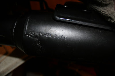

Got my 82 XL500R running today's after my restoration. Never heard it run before but it seems to be very loud.
Are they loud bikes anyway? Anything I can do to quieten it down? I've got the stock muffler on it and its in good condition, no rust or holes
http://www.youtube.com/watch?v=hfGiy...UBkryg&index=1
Thanks :)
Originally Posted by Al Tuna View Post
Sounds a bit louder than my 82, hard to tell on the video.
Is the little cover plate in place underneath the very rear of the exhaust?
Mine is louder than I would like for it be.
Yeah, can't really tell from the video. Not sure what you mean. There is no plate underneath the exhaust. Inside the cladding/outer packing (whatever it's called) looks very good.
I went for a ride today and it's very loud. Apparently i could be heard easily about half a mile away
Anyone have any ideas on how to quieten the beast down?
Part 12. Source
I see. I don't seem to have the cover on mine. Just had a quick look on the internets and saw that without the cover, it can sound poppy and farty. Exactly how mine sounds. Seems to be popping/backfiring a lot on decel
Yours seems to be modified.
Hmmm... Interesting. I may have to invest in another muffler. Don't get me wrong, I love a noisy bike but this just takes it to a whole new level. It really is a bit too loud for me.
May get this if I can't find a stock one
http://www.davidsilverspares.co.uk/X...2/part_31684/#
Doesn't have the cover but I've had a musket muffler on another old Honda and found them to be good.
Thanks for the help BTW, really appreciate it
The #12 cover was missing when I acquired mine. Fabbed a cover and it solved my problem, was hoping for an easy fix on yours.
Glad I could help.
