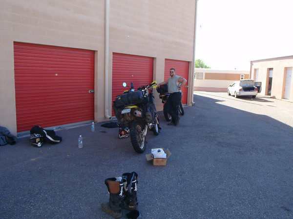

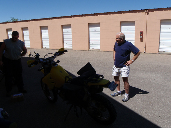

Bike prep

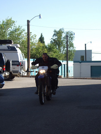

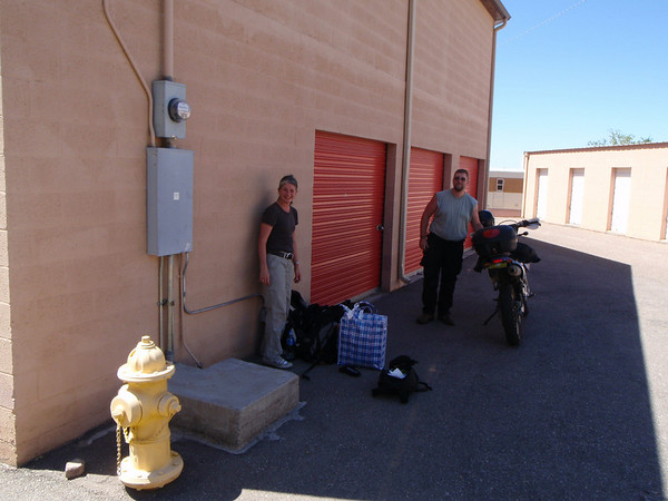

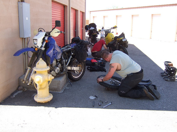

The mighty Todd was a Godsend!

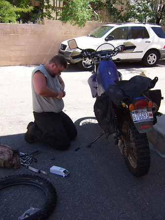

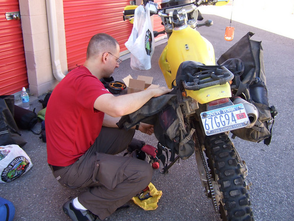

We pulled the bikes into the only shade in Albuquerque, and set to work... Unpacking, repacking, front tire change, change petcock, reattach gas tanks...

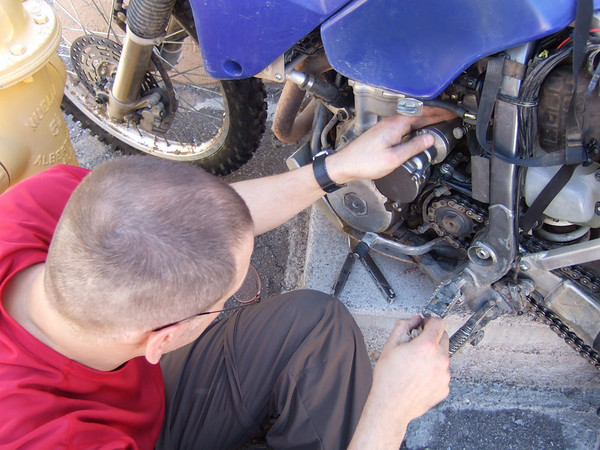

Todd has his own DRZ, brought tools, and jumped right in. What kind of saint gives up a beautiful Saturday afternoon to help get a couple of New Yorkers back on the trail? Thanks a ton for all your help, Todd!

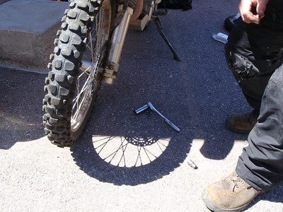

Especially for bringing a BMF wrench to get off the stuck front axle bolt on Blueberry:
Turned out to be a SOB even with that... almost could have used a breaker bar.
Don from A-1 stopped by... great guy, very friendly and accomodating.

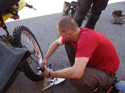

And while Todd worked on the tire change,
I started on the gas tanks,
And LDF took photos after sorting out our gear.
Focus, babe... hand me a wrench or sumthin' over here.
DR. Rock screwed with this post 01-29-2009 at 09:31 AM

I figured we'd be done in at most a couple of hours, and on the road by 3pm.
Tire on, inflated, looks good:
OK, so the bead wasn't setting on just a little part on one side... we'll just get going, ride on it, and try to reset it once it's warmed up some.
Note:[ -- never again! The solution as it is to most problems is MORE LUBE!]

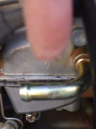

Mile 0, first leak licked

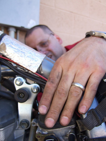

So it's gas dripping off the bottom of Blueberry's carburator:
So... pull the seat and tank, unbolt all the crap in the way, loosen the throttle cables and boots,
rotate the mother to gain exposure and... the float bowl gasket is dried out and not holding a seal. Of course I don't have another, and now it's 4pm on a Saturday. We call one dealer... they'd have to order it, a second one is closed already.
Not the way we wanted to start the trip, but what the hell, looks like a field repair is the only option at this point.
I feel bad for Todd, 'cause I know he wanted to ride out of town with us and we just can't get going...
So I break out some RTV black silicone, and schmear some on top of the gasket... "how long does it have to skim over for?" "two minutes should be good"
Lo and behold, leak fixed. Now, admittedly, the priority here was to fix the leak, and I was, er, a bit liberal with the silicone application which caused some other er, issues later... but in due course.

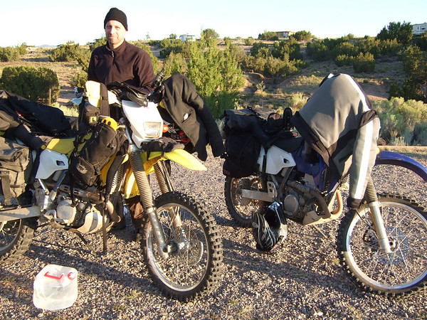

Day 2: Sunday Sept. 7, 2008
And so did we...
Amazing what a little sleep and sunshine can do for morale
We took our time getting the bikes repacked:
Fueled up,
It was like the night before was just a bad dream... did we really change that flat, and then ride through all that dust and sand and almost run into all those animals and set up camp in the dark exhausted???

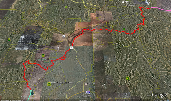

Our goal for the day

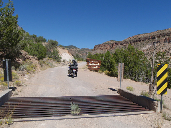

was Cimarron Canyon State park, where we stayed towards the end of Mobius I. We got dumped on with snow that time, and had to divert to Taos, and skip riding forest roads through Carson National Forest; this time we were determined.
First, we boogied through Santa Fe National forest, only stopping a couple of times since we had been there before.
Busted out the Adventure Bunny:
Great weather, great smells, great views... what more could you want?
Even some technical riding... FUN!
Before we knew it, we were through Santa Fe N.F., and back on pavement through Los Alamos.

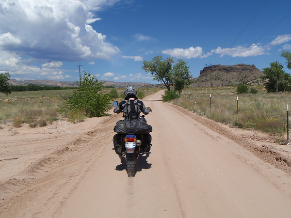

The next section, we had taken pavement through on Mobius I. It traverses a valley, along the Rio Grande, through several Indian Reservations.
Before we got onto the dirt again, heading down into the valley (temps rising in the blazing sun with each 100ft we descend), Blueberry's engine cuts out.
It restarts, but as soon as you crack the throttle past idle, it dies. Hmmmm.
We let it sit for a few minutes, discussing our options, try it again, and it's fine.
LDF's confidence in Blueberry's reliability takes a hit, but otherwise we're back on our way, trying to pick our way through the dirt road mazes of the Reservation land.
The road turned to deep sand,
and then petered out, despite being clearly marked on the GPS.

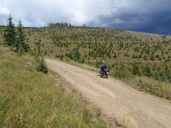

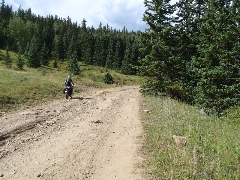

At elevation
for the first time... I mean above 10,000 feet. We weren't quite sure what to expect.
But, ya can't win if ya don't play... so shove off, eh?
Started out nice and graded...
And as we crested up onto the ridge two things happened which would become a recurring theme... the trail would get much more technical:
And we both would start sucking air from the altitude.
But the riding was awesome, and we were just getting our first taste of life on motorcycles above the treeline.
Gotta stop soon for a rest.
