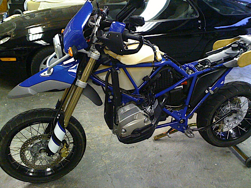

Maverick: I'm taking my pile into the dealer tomorrow for rear main and rear transmission seal and fork rebuild......had to take it apart to clean all the road crap off everything after the trip....and can't think of a thing the trans needs, even though it's going to be on the bench anyway.....bruce
