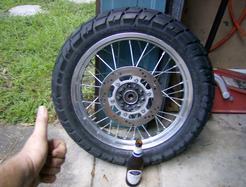

Old 07-29-2012, 12:47 PM   #37
ausfahrt OP
mach schnell
ausfahrt's Avatar
Joined: Apr 2008
Location: Currently Fl but Vt bound THIS year
Oddometer: 1,429
Success!!
Well after four inner tubes selflessly gave their lives for the greater good of teaching me to change a tire, all is good. I ditched the No-mar after the first pinched tube and used Motion Pro irons on the rest. The rim shows a few scars from my ordeals but what the hell....it's a KLR!
Thanks for all the tips, tricks and hazing...you guys are great.
To the victors go the spoils. I allowed myself a celebratory adult beverage afterwards.
Mess with me and you mess with the whole trailer park.
ausfahrt is offline   Reply With Quote
