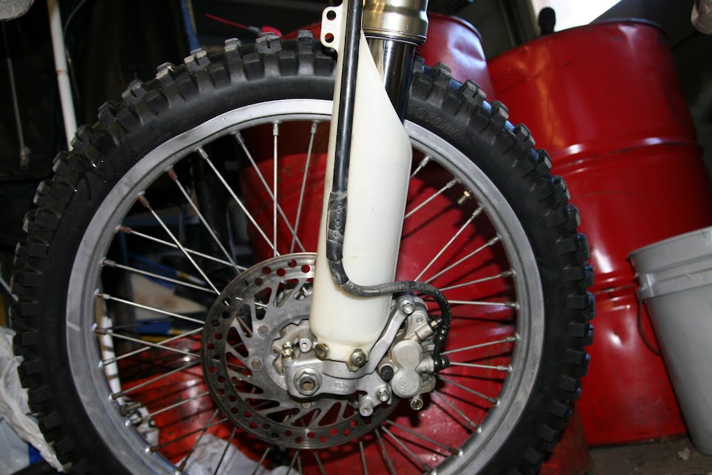

Originally Posted by kenny61 View Post
Got the CR250 forks installed. Still need to pick up one of them vapor thingies and clean up the wires but she's ready for a test ride if my back can handle it.
Anyway just figured I would post up some of the minor problems I had
Manracks tie down points. just need to elongate the elongated hole a lil bit more and put em on the top clamp
While I got the risers to work with the stock length cables they are a lil tight and I might wind up getting longer. Not bad for the clutch because I wanted to replace that anyway. but I just replaced the throttle cables
Brake hose clamping point is different. not sure what Im going to do yet. Anyone????
Thats it for now
What risers are those? Link please?
For the brake line you definitely want to run it on the inside of the fork leg. Zeta makes a sweet brake line holder anodized red for $16 bux at Wheeling Cycle Supply. It will work for both braided lines and larger OEM lines depending on how you mount it.
