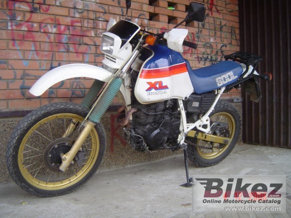

The older XL600LM sold in Europe had tubless rims. The rim had a raised ridge where our spokes go and it was drilled for the spokes. Not sure they could be fitted to our hubs or not? The rear is a 17" rim also.
