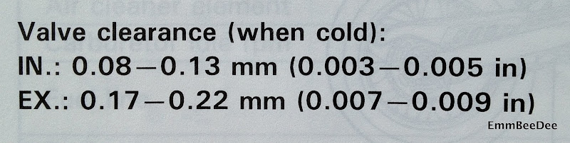

This'll be old news to some, but I thought I'd post it anyway.
After a friend from Newfoundland rode my DR last weekend I started to think about what maintenance I had done on the bike since I've owned it and aside from oil changes and carb work, I realized I'd done virtually nothing on the bike!
When I bought it it had 24,000 kms and now it has 35,467, so the valves were ready for checking. They're called for at 12,000 km intervals, which was nice to see.
As some of you already know the valves on the DR are screw adjusted.
There's not a whole lot involved with doing the valves but here's what I did:
  • Removed side covers, seat and tank.
  • Wash bike to remove years of mud.
  • Blow dry the engine with compressed air to get water and dust off.
Now the actual valve adjusting begins:
  • Removed one spark plug, remembering to blow compressed air down in the plug cavity so any dust stays out of the plug hole.
  • Removed crank nut cover and timing plug.
  • Rotate engine counter clockwise to compression stroke and line up the T in the hole.
  • Take off valve covers.
  • Set valves to indicated values. (See below)
I made up a little tool to rotate the square valve adjuster tips. I had found a suggestion somewhere to use a Robertson screw (only in Canada, eh?) head to hold the adjuster, and a wine bottle cork seemed just the thing to hold the adjuster with.
Here's the tool in place.
These are the tools you need - a feeler gauge bent to shape so it goes in easily (there's not a lot of room in there)
So all in all, it's an easy job!
