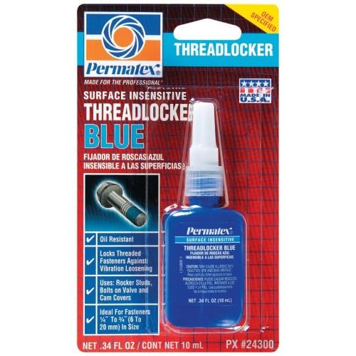

good to know, need to do mine ASAP....BTW there is oil resistant threadlocker available, plan to use it when I do the job, especially if I don't remove the clutch basket
