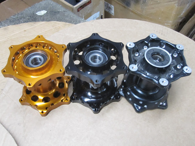

Hey Woody, Thanks for the photo of you guys inside your Denver shop; nice to see the faces behind them thar names!
Anyway, saw on your site prices that the Excel 19x2/5 front rims for KTM are in silver. What about black?
Other question is on Talon hubs for KTMs - the std ones not the carbon jobbies. Are they drilled for Japanese or European rims or can one choose? How can one tell easily which they are??
we charge $75 to strip and re-anodize the rims,,,this turns the standard sorta shiny Excel rim to a satin black look say 80% shiny,,to get em to look like oem excel we have to polish em up to high buff,,,add an extra $25
i'm positive Talon will spec their hub to work with oem ktm indexing which is euro i believe,,,,want a universal hub???,,,,made in usa??? ,,,,try the RAD hubs,,,i speced em and had Bob add an extra set of spoke holes instead of lightening holes...thus making the hub be capable of any index and or lace pattern..see the difference below...just $299 and your choice of hub color!!!!
