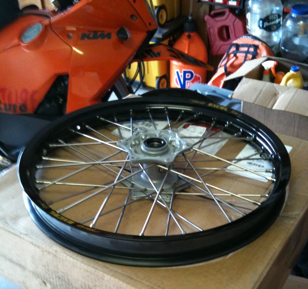

New 990 front wheel
Woody,
Just received the 990 front (new 1.85 Excel, stainless spokes, super lace, new bearings). Looks great (bad cell photo) and rather indestructible.
Sure is an improvement over what I sent you.
Thanks,
Jack

990 Wheel
Thanks for the opportunity. Enjoy and let us know how it performs for you.
Chris
