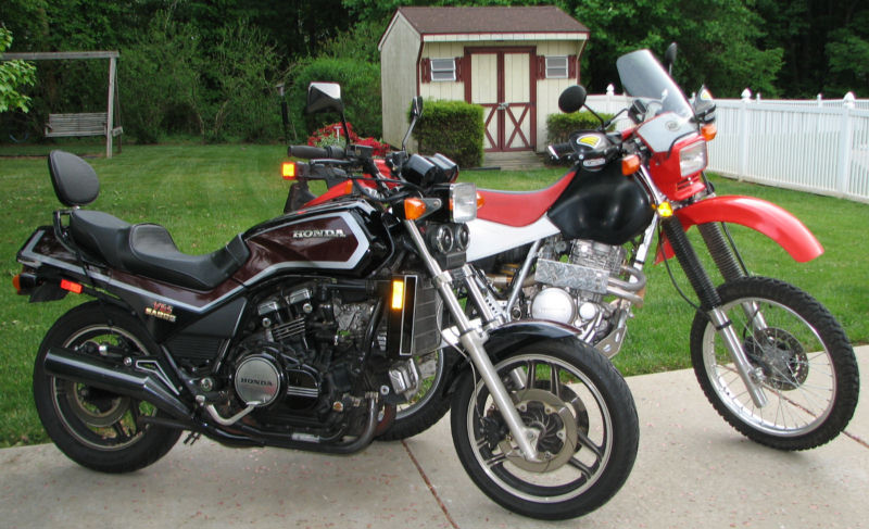

National cycle faring...
No tools needed to thumbwheel screw it on or off the bike. Ride long slab with wind protection to the dirt and take it off in about 10 seconds. Put it back on to go home. Got an extra set of bar mounts for my street bike and it does double duty. Less buffetting and cleaner air than a laminar lip and yes I rode with laminar lipped farings for 20+ yrs. You can also change the rake angle of this one to your fav angle. Cuts down on headshake and is super lightweight and cheap. Mine is off the bike unless I go for a long road ride. What more do you want?

OnOff,
That is the functional setup and best value. Especially like the looks on your Sabre! Looks factory.
