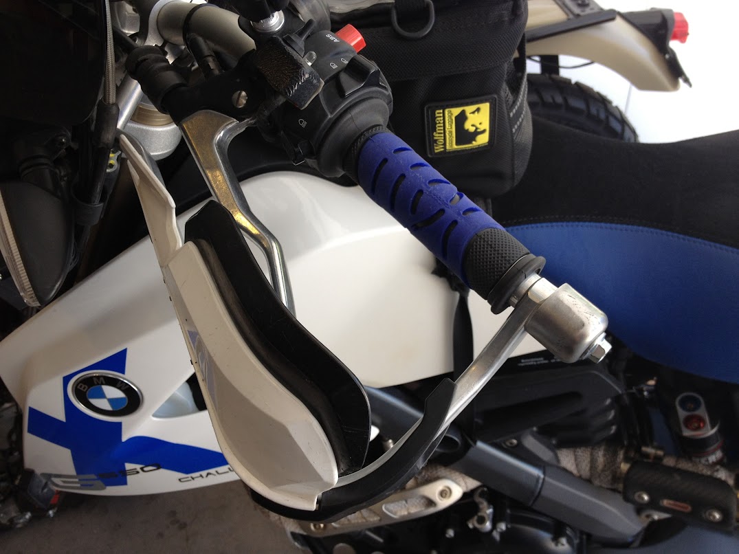

Bar vibes
So I had pretty bad bar vibrations at about 80mph +/-2mph and tried the Vibranators to reduce it, which didn't help much. I then got some longer bolts and installed a pair of heavy bar-ends I had lying around from my Thruxton and these have reduced the vibrations by 80-90 % at 80mph and smoothed out everything else before or after.
Problem is they stick out and are vulnerable in an off-road drop. I might try the Bark Buster ones now, even though they are lighter than the ones I put on and might not be as effective.

the stock x-country bars have integrated bar-end weights. maybe try and get some of them?

X-country bar end weights
For what its worth, the BMW fiche lists the same part number for the bar on the X-Challenge and the X-Country. Therefore the X-Country adapters (#32 72 7 710 446) and absorbers (#32 72 7 708 773) should be an easy install on any X-Challenge. The adapters thread into the bar directly, and the absorbers are the actual bar end weights. These bolt to the adapter.

Yes the bar end weights work well with the touratech hand guards. I have the XCountry with the stock bar end weights and they should go right on the Xchallenge bars no problem. All I did was slice off the rounded part of the weight so it fit flush with the guard and there you go. You have to use the stock bolts from the weight to fasten the guard at the end, because the bolt from Touratech is larger.
