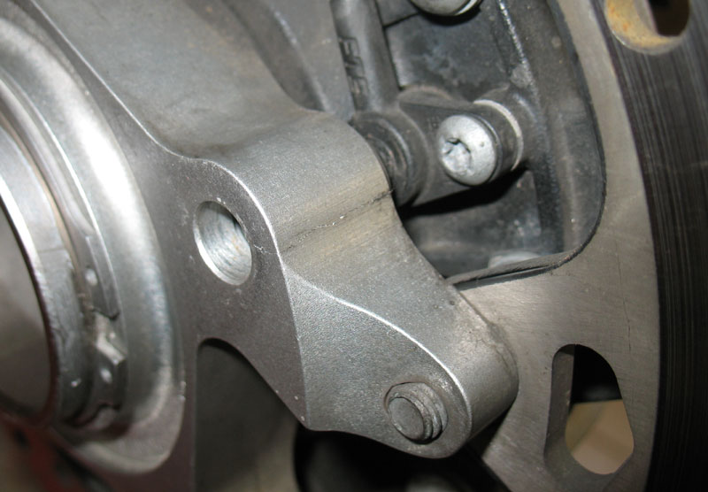

While changing tires yesterday 02-16-2010, & checking the rear Disk Flange. I discovered that 2 of the lugs on the updated replacement flange had developed cracks in the same location as the flange from the original post!!!
As part of my Case for BMW to step-up and fix this problem I read all post I could find and review all picture that show Lugs with cracks or broken lugs. It appears that when the cracks are present they are all in the same general location as the ones in the picture in this post. The local dealer has shown genuine concern and I supplied them with a stack of pictures as well as my original cracked flange. I will post what ever the turnout.
Looking for any others who may have had this problem.
On the way to the Swamp Scooter’s Rally this month my rear wheel looked like it had oil spots on the rim. When I returned home I pulled the wheel to check the seal area behind it for any signs of oil. While checking I noticed that 2 of the ears of the flange that holds the disk had hairline cracks running parallel with the boltholes. The cracks penetrate all the way through to the inside of the machined threaded holes. I then cleaned the area replaced the wheel and called the local dealer explaining the problem.
The service writer asked that I bring the bike in so they could take a look at it. The next afternoon I was at the dealer so they could have a look. The service writer said that he had never seen or even heard of this problem. He informed me that he would contact BMW via a PuMA explaining the problem and asking for a recommendation. BMW responded by saying that someone must have removed the wheel at some time and over-torqued. They also said that they had not seen this before and asked the dealer if they could identify the original cause. This is not a rant about BMW not standing behind their products, it is simply a request for others that have had or seen this problem to post a reply. Most importantly it is a heads up to you guys to keep an eye on this part for any signs of a possible failure…

Strictly on an engineering/mechanical point of vue, I have a hard time to believe that over-torque is the culprit...
It is hard to speak from pictures, but the fact that bothcracks are at the same position and not in the area of minimum material thickness, would indicate a radial load.
This would occur with under-torquing and/or extreme load (i.e. braking)...

This is the first insantance of this posted here. Are those holes where the wheel bolts fasten to? If so, is it possible that someone over torqued the bolts when installing the wheel?

It's the rotor bolts. Can you show us a picture of the other side? Almost looks like one of the bosses has a flat spot in it, although it might just be the lighting.

I can't imagine the rotor bolt would be the only culprit. You really can't get a whole lot of torque on those without rounding the socket.
Perhaps the rear brake was dragging? Any signs of discoloration on the other side of the part? Any blueing or heat checking on the rotor?

The holes are where the disk mounts to the flange. The disk would be flat on the other side.
AntonLargiader,
Flat spots, you are correct, it is just the light.
Gadget Boy,
I am the only owner and no the disk has never been removed or re-tourqued.

Thought I'd mention that I've seen a similar case. I'm pretty solidly convinced it's from overtightening; in this case it's the wheel lugs rather than the brake rotor bolts. All five show the same crack:
If this (or the previous example) had been caused by an external force, I'd think that the part would have broken away once the crack happened. Overtightening, the force was relieved once the crack occurred.
It initially seems like a dangerous failure mode, but when it comes down to it neither part failed in use after the crack happened, so the flange is strong enough for its task even with the crack there. OTOH it's hard not to think that the part might not crack with another millimeter or two of material there.
This might be a good one-time inspection item for people who don't know the full service history of their bike.

Good point. 60 Nm for the wheel, 30 Nm for the rotor. Work up to it incrementally, in a star pattern in either case.

Thanks Anton! And one more thing: Apply the bolts DRY!! NO Loctite, or anti seize compound.

Anton....dumb question, but if a bolt is not torqued enough, could that generate enough movement/shock to fracture a flange?
