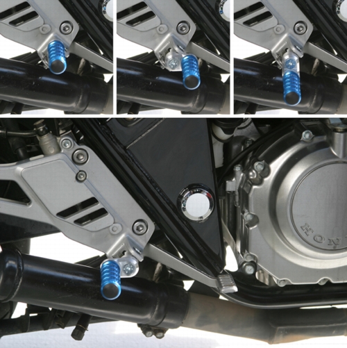

Old 08-22-2008, 03:07 PM   #75
tonymorr OP
Malta,NY(Saratoga Spring)
tonymorr's Avatar
Joined: Oct 2004
Location: Malta, NY
Oddometer: 2,121
Send a message via AIM to tonymorr Send a message via Yahoo to tonymorr
Originally Posted by TINGLER
wow.
That rules right there. Lots of creativity for sure.
I know it's just a detail, but could or would you think about possibly changing the tail to something more "dirtbike like"?
Aesthetically, I think it could go more towards the dirt. The passenger pegs kind of don't flow with the overall concept either (IMHO). Can those come off and possibly be replaced with something more utilitarian looking? That whole area looks kind of swoopy and stuff.
......but man, I'm being an armchair builder here living through you and it's your bike. Don't take my comments as anything other than suggestions. Hopefully you see it as constructive criticism and nothing more.
By the way, I'd love to have that bike. Seriously, it's cool as all get out.
Thanks, keep the ideas comin. I'm heading out camping overnight but just checked in so here's a quick response. I'm thought about making a whole new peg bracket as I think I'm going to want the pegs lower and more forward. I'm going to leave the stock baracket because I'm going to be mounting Stormcases(Pelicans) and need something to hold the bottom of the bracket. I think I'm going to try these....
The tail will be covered by the cases so you won't really see it much. I may just cut the plastic so the bags can fit in tight as possible.
Off to camp, more info tomorrow......
