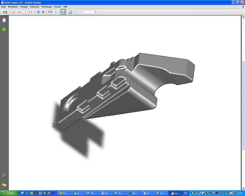

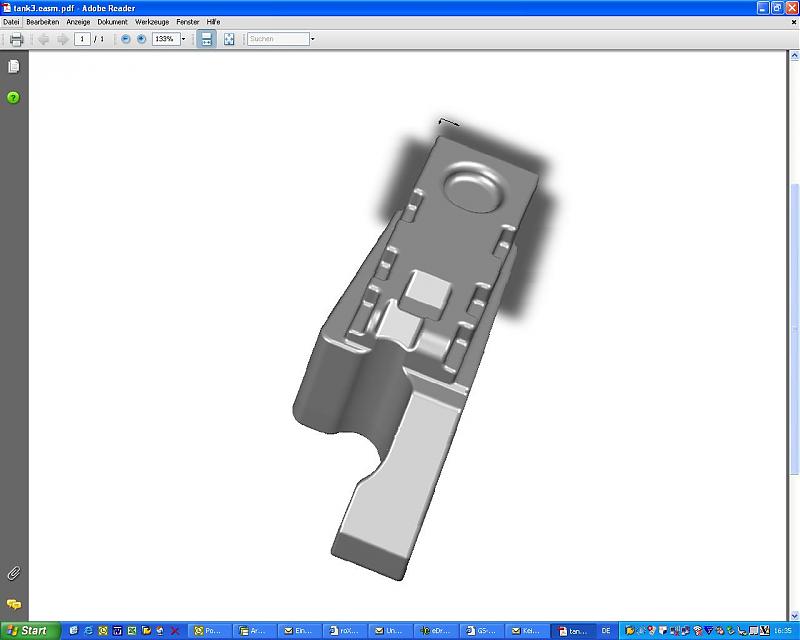

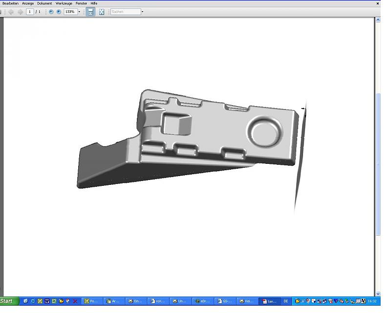

congrats, this is a piece of the art, look how it is addapted to seat holes and vanes, look how it deals with shock support form.
each info i see, i feel better about having it soon.
Thank you
