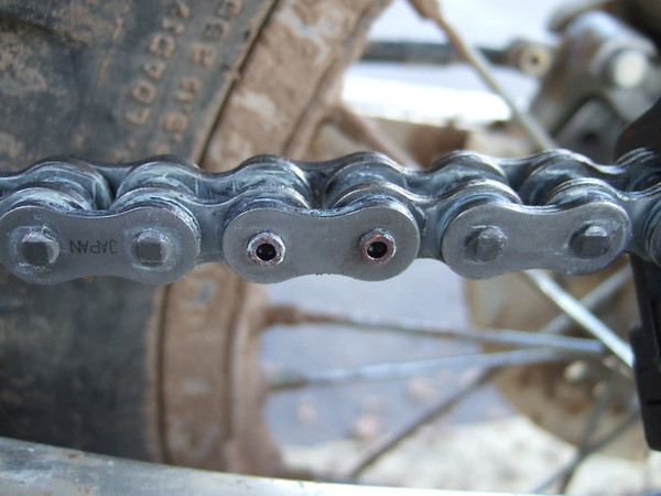

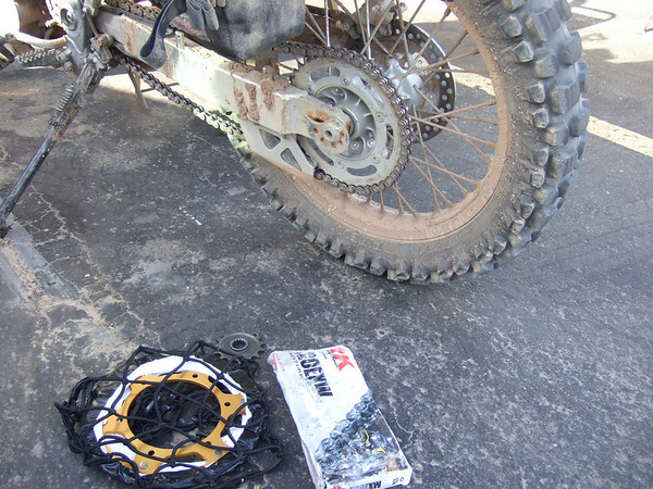

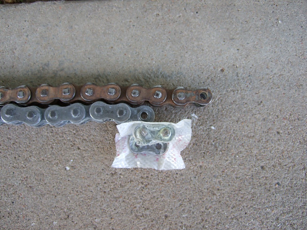

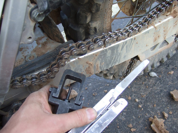

First order of business is to replace blueberry's drivetrain. I knew both bikes would need a chain replacement, and I had bought parts to do both... That's some heavy parts, though, so I left one chain / sprocket and chainring set at home, and only brought one. I was hoping one bike would make it to Albuquerque with what it had, and I waited as long as I could for the worse worn one to declare itself. By Liberal, Blueberry's snail adjusters were all the way out, and I had been tightening them almost every other rest stop for the past day... it was cooked:
I filed down a pin,

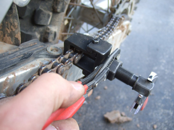

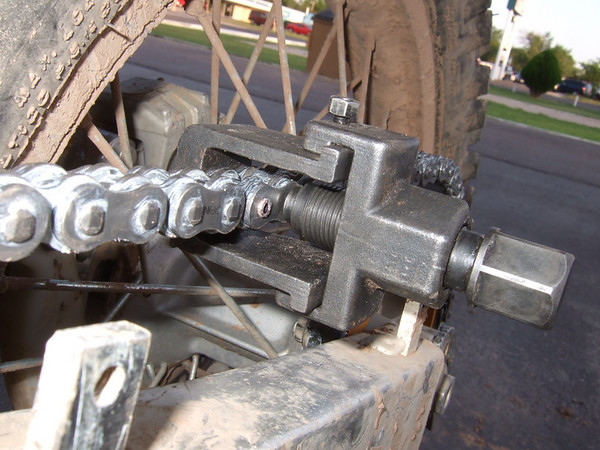

And broke the chain with my $16 DID knockoff tool from Mike'sXS.

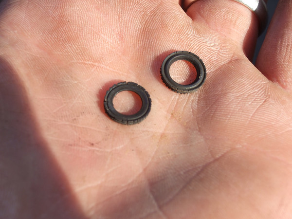

Yeah, these rings are done:

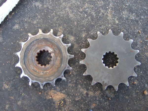

So is the front sprocket:

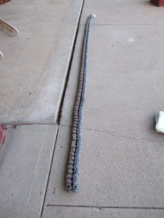

And the chain... stretched about 1.5 links compared to the new one:

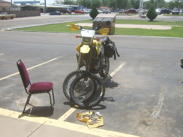

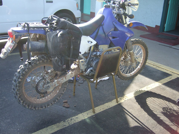

I scavenge a discarded chair from behind the restaurant, and voila, instant dirtbike lift:

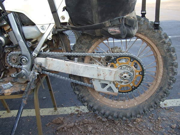

Rear sprocket

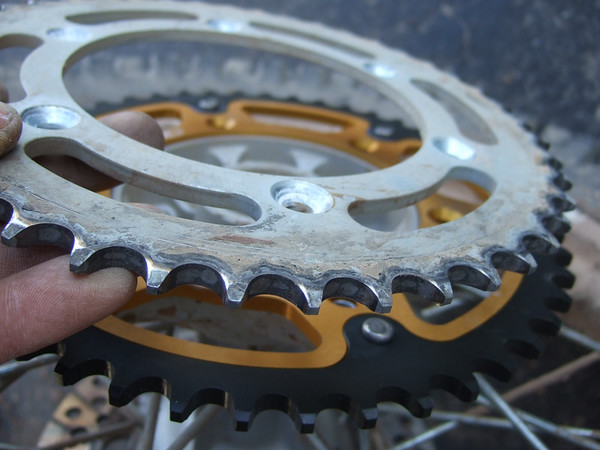

Actually wasn't too bad:
But I had decided to gear both bikes to 15/47, mostly for chain longevity (minimizes the frequency with which each link falls on the same tooth)... Blueberry started out 15/44, so she'd have a little more torque down low... perfect for the next sections. Honeybee was already geared at 14/44, which is almost the same, (lighter weight), but wears the sprockets a little more quickly in theory.
I splurged and was mounting a fancy aluminum / steel sprocket which is supposed to wear really well... the theme here is durability, in case you haven't noticed.

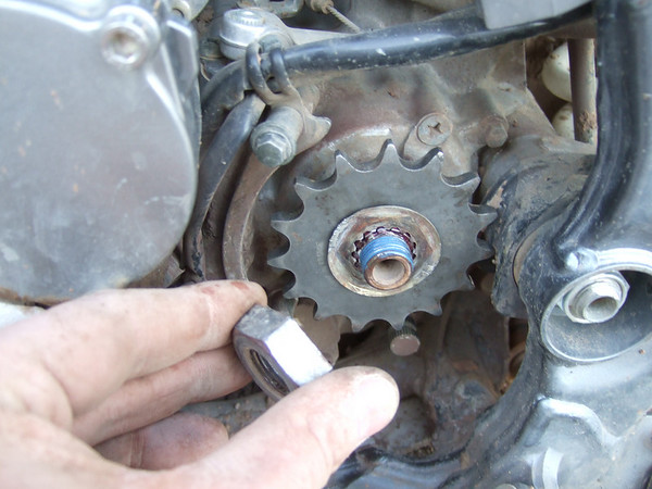

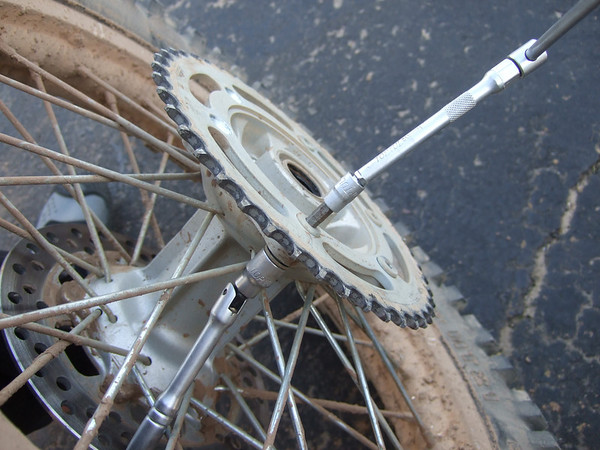

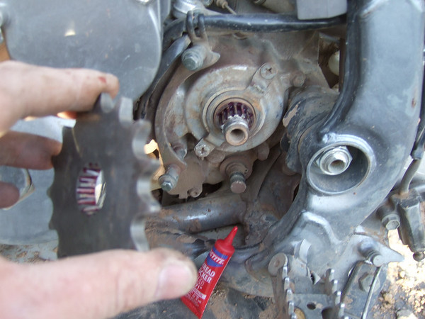

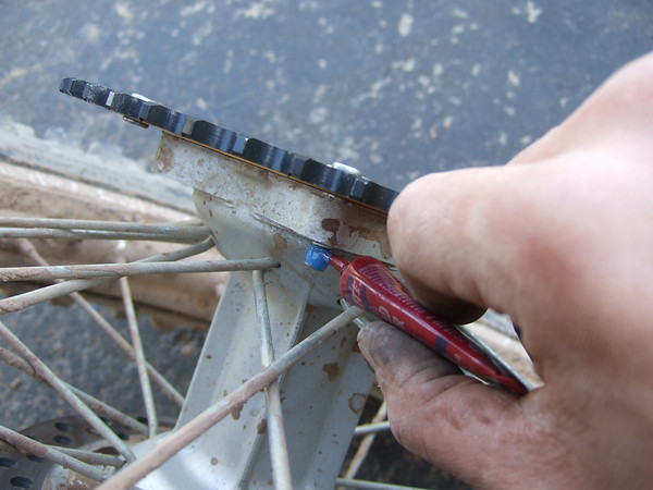

Another round of locktite all around... on me
The reason I wanted to get this done this day was that if I ran into a frozen bolt, or any other difficulty, I'd know what I needed first thing in the AM when we would go to Milhon's Cycle, rather than start, get stuck later in the day, then have everything be delayed...
But everything came apart smoothly, and went together the same. Blue locktite for the nuts:
Red for the sprocket splines:
And blue for the sprocket lock nut.
Point being, I have read the DRZ thread here, and the forum on ThumperTalk religiously.
Thanks, fellow DRZ riders.

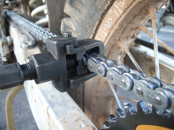

Now for the last small matter of riveting the new master:
Oh, did I mention that I've had about 4 Jim Beam and Pepsi's by this point. They're very refreshing.

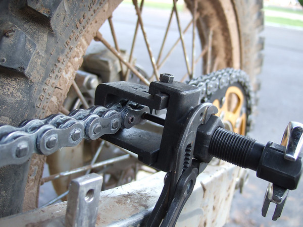

Getting stupid
Press the plate on:
So far so good:

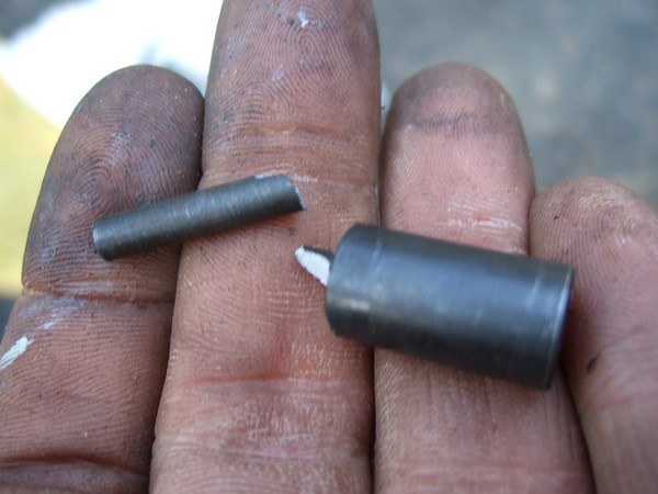

Anybody see anything wrong with this picture:???
And can you predict what will happen next?

Lemme guess, ya broke the riviting tool.
I haven't used one but it looks like the pin is going to bend/snap.
Why didn't you use a master link?
I'm glad you did your research on DRZ's on TT. Endless source of info there.
kelsow is offline   Reply With Quote
Old 06-10-2008, 06:10 PM   #174
DR. Rock OP
Part of the problem
DR. Rock's Avatar
Location: NYfC, yff
Oddometer: 5,341

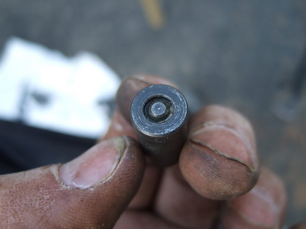

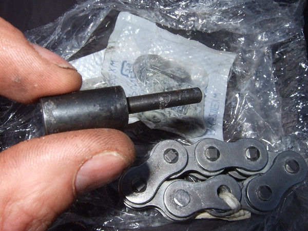

Bingo, we have a winner!
Why a rivet master? Personal preference... If riveted correctly (as demonstrated below ) I think it has less potential for failure. Nothing flagrantly wrong with clip masters, but starting with a new chain, I try to rivet.
For my field repair / spare parts kit, I have a short section of chain, and two clip masters so I can splice in a few links if necessary. The Motion Pro T-6 tool that I usually carry when I'm not planning to replace a chain as I was on this trip (and the next leg) is not capable of riveting -- only breaking and plate pressing -- it's also much lighter than the DID knockoff.
Of course, this is the end of the pin I was supposed to use:
Which was still functional even though the chain-breaking pin was broken.
One down, one to go:
For the record, boy scout had a spare pin up his sleeve...
But I'm keeping the broken one in my kit, just to remind myself to measure twice and cut once, humble pie, don't drink and wrench, keep yer head in the game, and all the rest.
Whats with red locktite on the splines I have never heard of that but maybe I should have, Nice Report
huggybear is offline   Reply With Quote
Old 06-11-2008, 08:40 PM   #179
DR. Rock OP
Part of the problem
DR. Rock's Avatar
Location: NYfC, yff
Oddometer: 5,341
Red Loctite Countershaft fix
Check out here,
and here.

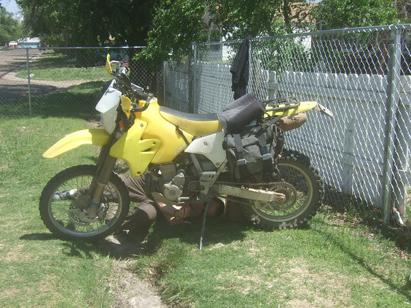

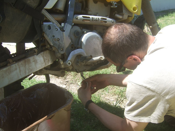

Back at the motel, (not wanting to pull a TDB Baja field-oil-change fiasco ) we pulled the bikes around back to drain the oil, catch and recycle it.
I quickly realized that I didn't have a 14mm socket long enough to reach the drain plug. I didn't have a 14mm socket at all, and wasn't to excited to take skid plates off both bikes... luckily there was a NAPA within easy reach, and I was able to procure a 14mm tall 1/4 in socket which now lives forever more with the DRZ tools and spares kit.
Next job, front tire change... no problem
We took a side trip to find a battery for the VaporTech on Honeybee which was necessitating resetting the clock every time I started the bike. While I worked on that, LDF got cracking cleaning the air filters:
We are a good team, I don't care what she says.
