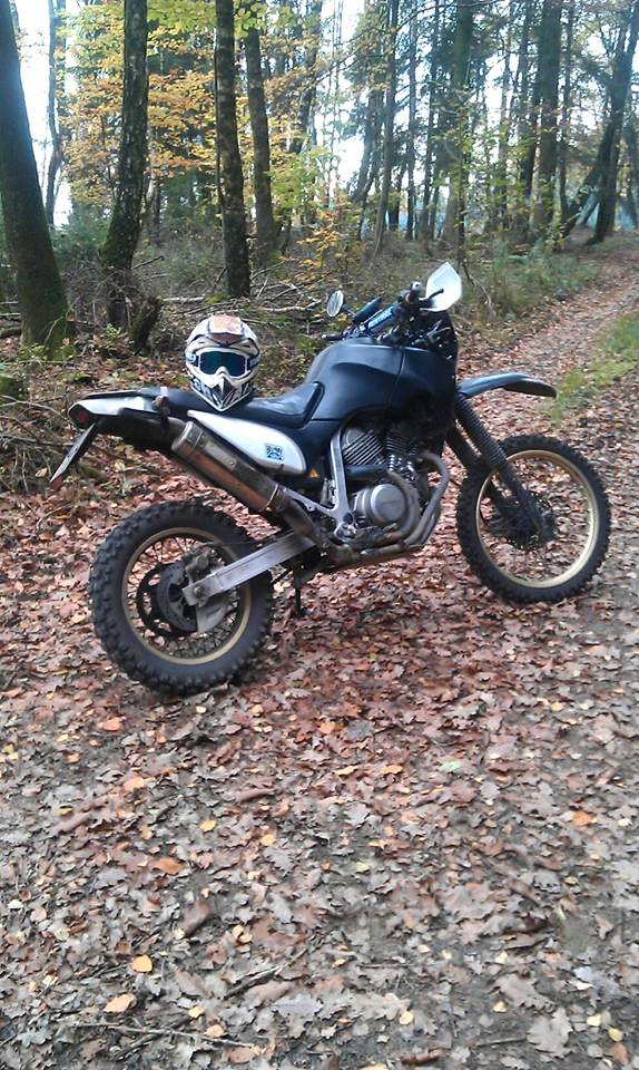

Looks great!!
Lets ride around the World...
