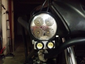

Getting there
Well, between work, work, and building my friends' 77 KZ400, 78 XS750, and 78 XS650, I've been slowly chipping away at my TransAlp mods. Ran errands on her all day today, and have to say she rips!
Better pictures and details of mods to come.
