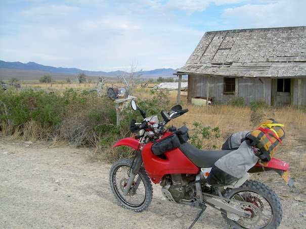

atreiou
XR 650R Rider
Joined: Jun 2007
Location: Verona - Italy
Oddometer: 45
my 2012 Desert PIG
atreiou is offline   Reply With Quote
