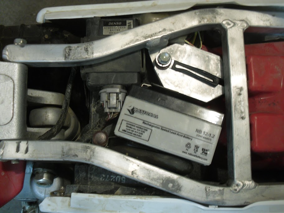

I'm rocking a 15$ battery under the seat... I'd have to ask my buddy the product number but it was 10$ + shipping.
Ahuh! Found it:
http://www.batterysharks.com/Nationa....2_b12-1.2.htm
That's not my bike, but you get the idea. It fits. My buddy installed his with his wiring jobbie in there, and I fit mine across the bar because my set-up is different with a steel subframe.
Works AWESOME for using signals on side of highway, keeping voltage high at idle to run multiple accessories, and charging phones at night. Solid addition to the XRR for dual sporting for sure.
We had a 4$ adapter that used my GPS power cord and plugged our phones in. After a few drinks beside the fire the phones would be charged!
