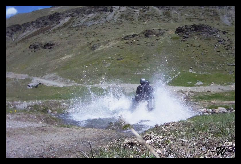

We just came back from 6600km / 4100miles honeymoon trip. No problem with two up at all - not even river crossings (well little complain from the missis was that the boots aren't anymore waterproof if your feet are half a meter submerged..)...
..and no stock parts in suspension - rear & front travel are also 250mm both... .. , but the seat is stock!

What did you used for the front end to get the extra travel, and the rear end as well?
Front end has Aprilia RXV Shiver insides, stronger springs etc. and rear shock is custom made WP Fusion.
Actually both ends have 275mm of travel, but currently I have limiting spacers since I'm only 1.80cm/ 5"11 and with 275mm of travel it is a "bit" challenging to ride offroad two up since my feet won't touch the ground.... ... .. .
...notice the wheel clearance between tire and fender to compared to stock F800GS... (picture from last years trip to Artic Circle -> only soft bags in more off road orientated trips)

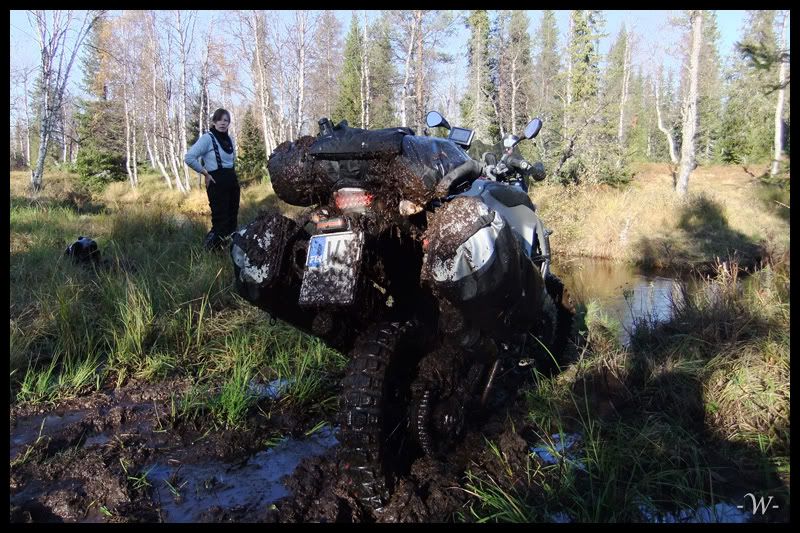

No problem with the upper bolt anymore (bend five or six 12.9 bolts before that;) since I made my own fitting stuff for the WP. Shock itself is decent (needed revalving from the new -> valving was done more to road than true off road, even though I asked more off road orientated), but unfortunately the hydraulic preload adjuster & customer service of WP sucks big time -> no more aftermarket WP stuff for me and can't really recommend them either for same reason..
Hydraulic adjuster was leaking from the new (hose connection & adjuster knob shaft), then the "WP Germany" didn't anymore replied emails (ques the company behind it went down or something), then finally got an reply from WP factory from Austria itself which pointed me to new German company -> sent the shock to be repaired the -> got shock back one day before my trip -> hydraulic preload adjuster failed completely after 150km in the highway ( this time collar itself gave up and I had to take it away in the middle of the trip and put proper preload mechanically) and now I have been waiting for answer to my emails concerning this about one and half months from WP factory & this company who did the "repairment" (collar was just fine before they did their "thing") -> no answer from either of them. So unfortunately I have to disagree with LukasM about WP's customer service... (and I also sent almost hundred emails back and forth to different dealers, WP, etc. when I was trying to buy the damn shock. Some of the dealers didn't know what they were selling and some of them were selling something what they couldn't deliver in the end -> won't be doing that anymore).
(upper bolt & fitting was standart in this trip)
..and in that earlier picture the rear tire is Mitas C-02, but normally I use MefoSport Stonemaster since it is much taller tyre compared to Mitas (pattern of them is pretty much identical).
What is wrong with F800GS when riding two up off road, is the shape of the tank -> there is no way that passenger can ride standing -> shape of the tank drops your feet away from the pegs..
