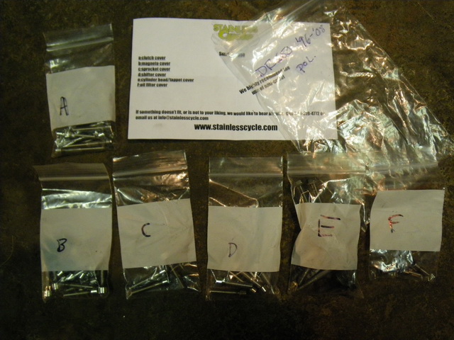

I take it this is the stainless bolt from Ebay. Do you like it and is it pretty complete?
That is the bolt kit form ebay. If you are trying to replace the visible bolts for that polished stainless bling factor then it is pretty complete. There are more bolts included than I had intended to replace so it will work well for me. Also, I like the allen head bolts better so far. Have to see how they are when the frame, tank, forks, etc.. are in the way.
Here's a picture of what they sent (E has my old head bolts in it).
Hope you can see the A - F list that says what's in each bag.

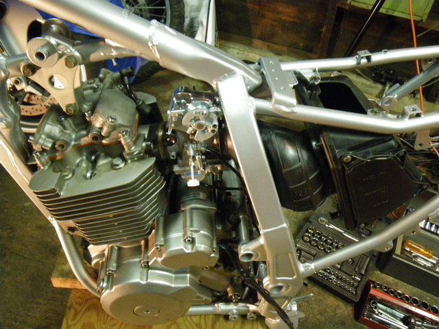

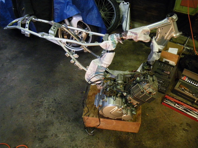

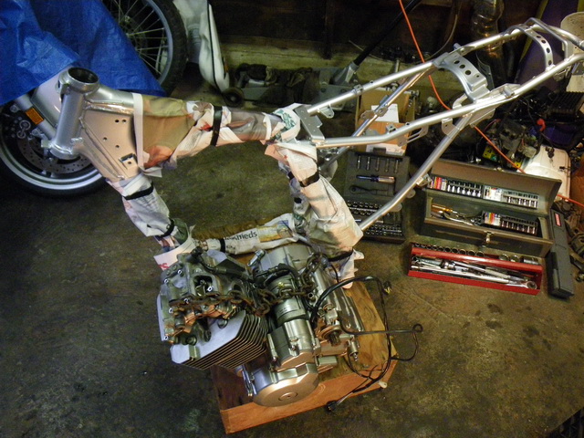

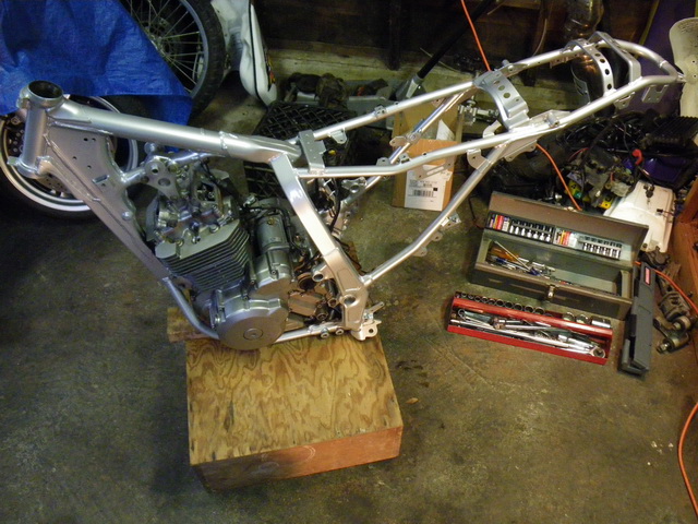

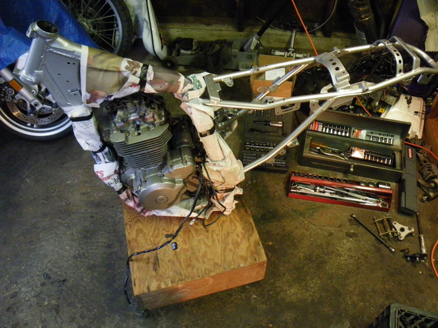

Reinstall Engine
I had quite a bit of trouble getting the motor out the left side like the manual says and it looks like there was actually more room on the right because on the right there is a removable motor mount. Taped some newspaper around the frame for protection.
I tried but the engine would not go in from the right. Added some more paper to protect the left side and ready to give the left side install a try.
Strange, it went in much easier than it came out from the left.
Newspaper worked pretty good.
I'm liking the silver frame quite a bit.

I don't want to tell you what to do but it looks like you are doing allot of this alone. When installing a motor in a frame sometime it helps to lay the motor down on its side. Then position the frame over it it can be a lot easer than wrestling the heavy motor into the frame.

I am doing this alone, so please tell me if there is a better way to do stuff. The idea of lifting the engine must be ingrained from working on cars. Hadn't even thought of laying the bike on it's side, doh! I had to twist the motor quite a bit to get it to come out. Seems like that might be difficult from the side as well, but I wouldn't be fighting the weight. Thanks for the tip Tim.

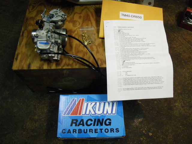

TM40 & AirBox

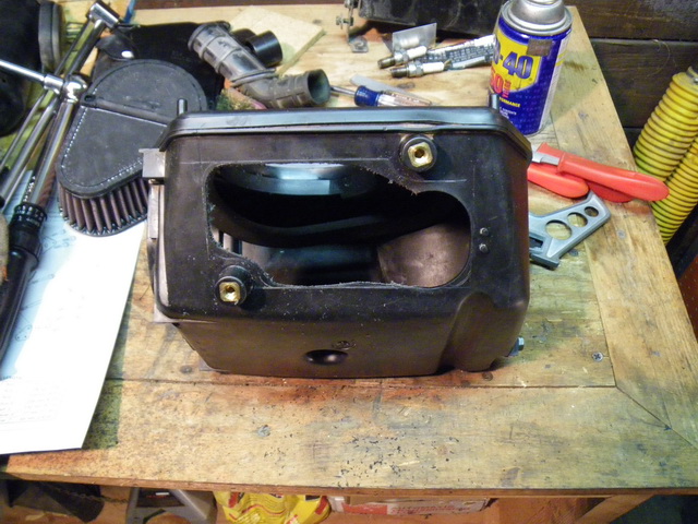

The TM40 kit from ProCycle comes with the TM40, a bunch of jets, new cables (not shown), a straightforward single page installation sheet and a printed version of the HS40 tuning manual (same carb but for Harleys).
The installation sheet says the TM40 is delivered with a 150 Main jet, 22.5 Pilot jet, the Needle clip is in the 3rd position from the top and these settings work great for most DR650s with modified airbox, aftermarket air filter and aftermarket muffler.

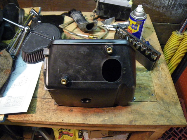

Sounds good to me! The PO installed a K&N filter. Just need to modify the airbox. I scribed a pattern similar to mx_rob's and Jesse's.
Then let fly with the key hole saw (shown in next picture).
Finished it with a wood file (rounded on one side and flat on the other).
Test fit looks good.

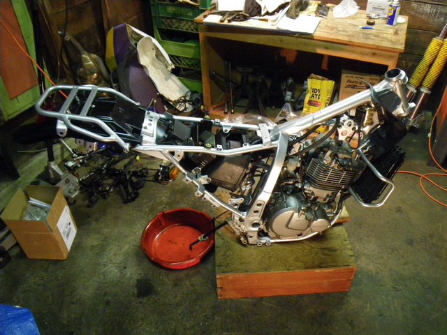

You can see the powder coated oil cooler guard and rear rack. When I took the rear rack off I saw that the rear mounts were bolted through the plastic fender only and just sat on top of the frame cross member they were supposed to go through. I thought it was odd until I tried to install it properly. What a PITA! The trick is to install the rear two bolts first, this pulls the rack and fender down to the frame and as the rear studs angle slightly forward it also moves the front holes closer toward alignment. Even with that, the front holes are not "aligned" and I had to reef on them pretty good to get the bolts to start.
