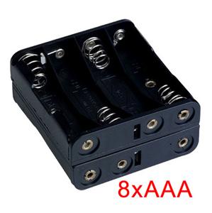

If it wasn't for the horn you could get away without the battery, the LED tail light will work on AC. If it were mine I'd tape 8 AA batterys together for the horn just to pass inspection and do without the DC system all together. If you must have the horn then make the whole system DC (lights and all) and forget about making a dual voltage system. Just disconnect the stock AC reg and connect the stator wires to the DC reg/rect and connect your lights there.

Sounds like wheeling cycle supply has the parts you need in there EZ electric wire kit. You can buy the parts separately!
  • easy-to-install electrical parts (excluding headlight, tail light and flashers) for competition bikes
  • installation made easy, even if you have no experience
  • power source for this kit is completely self-contained (using 8 double-AA batteries)
  • no need to 'chop' into your wiring harness
  • Moto LED tail lights and flashers are recommended
