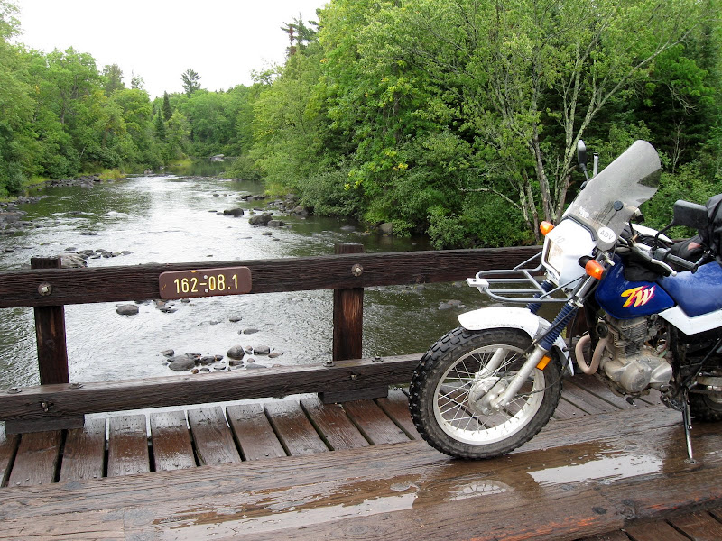

Mine came with the bike, others seem to know the source but I didn't care. It was one of the main draws to this particular TW for me.
And here.

ahhh that looks perfect this one is close, may go this route instead of getting another deflector
And here.
