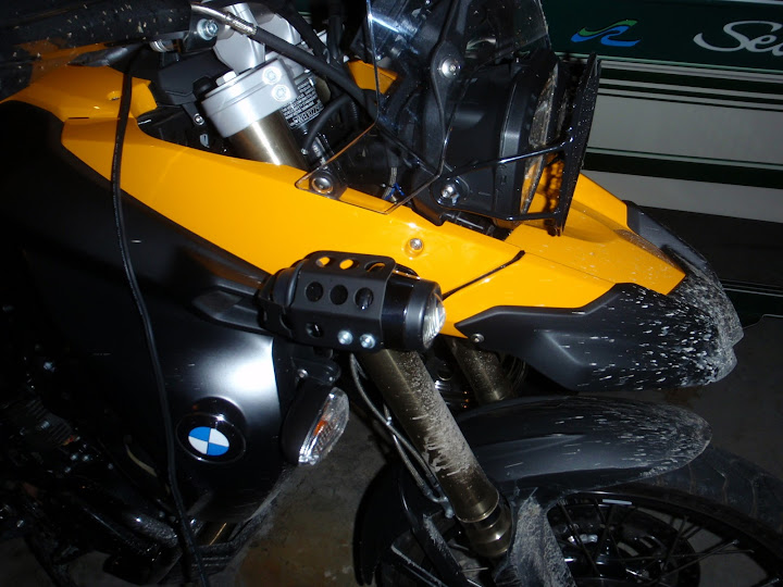

Here is another mounting spot to consider. Well out of harms way under here, plus it gives you a bigger light pattern to approaching cagers.
11 KTM 250 XC
09 BMW F800GS
Ithaca Dirt Riders--KLIM--Hammer Nutrition
JGRMX-Pirelli Tires

Old 04-13-2010, 08:49 PM   #143
edfetz
edfetz's Avatar
Joined: Apr 2004
Location: Hudson Valley, NY
Oddometer: 987
Another shot. No brackets required. The plastic seems plenty strong enough. I used a big washer under the nut.
Thanks for posting your pictures. I installed my lights in this same way based on your post and it works out great. Lights are nicely protected and they are far enough away from the headlight to not make it redundant.

Here are the Denali's installed and on in bright daylight. They work well in the trails lighting stuff up under the tree canopy.
The mounting location that edfetz used works very well.
