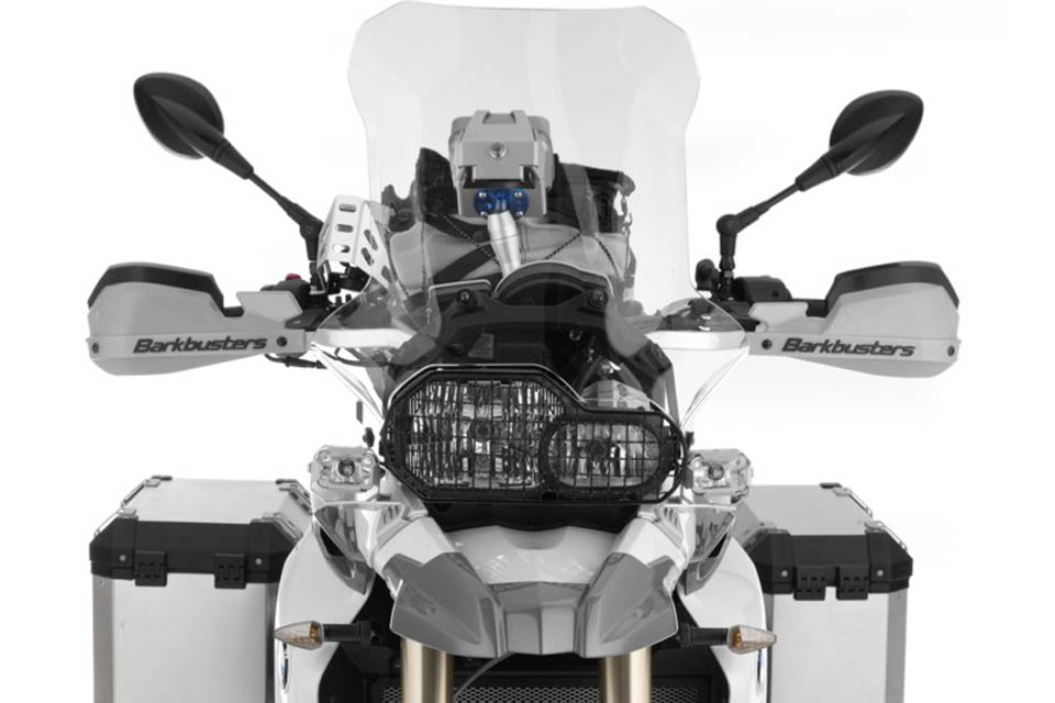

Pic of issue
You can see the white oxidation on the lamp lens and the 'bronzing' two tone - hmmm.
Shipped ground - should get to TT next Monday - will update.

I've had the Trail Tech SCMR16 HID on my 1200 for a few months now. I'm happy with the light output but I noticed that both lights have some smoke residue behind the lens. They look foggy but its definitely smoke residue. I'm thinking of cleaning the inside of the lenses. My question is does the bezel simply unscrew off? I tried to unscrew them but they didn't budge and I didn't want to break them. Thanks
Mine are mounted sideways, no problems with heavy rain so far just this smoke residue.

I had the same situation with the white haze. You should be able to see in pic above your post. When talking with Dave Petersen at BestRest he described it as oxidation and indicated it may be a symptom of a bad bulb. I would contact TrailTech for their opinion and 'how to' clean.

For some reason I can't see your photo but it sounds exactly like mine.
I just came in from the garage an in fact the bezels do simply unscrew off, they were on pretty tight. Unfortunately there is no way to simply clean the haze on the lens. The front lens is part of the bulb and they are sealed. Looks like I'll have to contact TT for replacements.
