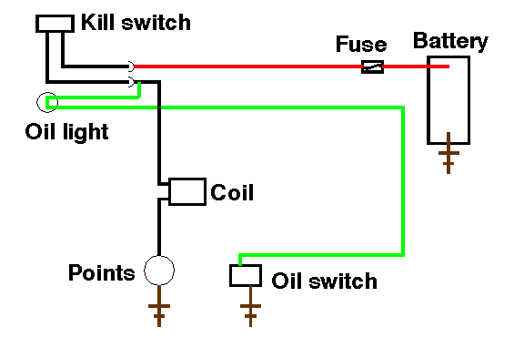

OK, so the next day, DanEdg came over to help me get it rolling. Wirwrker has graciously given me a battery he thought would be perfect for this application, and I accepted. I still owe him money, but he did say hang onto it and make sure it worked, so even though I told him I'd get him some dough, I havent, yet. I am saying this OUT LOUD and publicly so that I will get to it. I believe its a 3.5Ah AGM. The ignition will draw about 3A while running, so theoretically I'll get an hour to two of running.
First thing I did was pull the front cover: I knew it was going to be sparse up there. I was pleasantly surprised.
And I dont even need the rotor- right now its just acting as a front crank seal. Anton clued me into a larger seal that I can swap into there and get rid of the extra pound or two.
Condersor, Points. Thats it. No dragons.
System needed a ground wire, and this tranny bolt provided a good one:
Added some cardboard spacer to rest the battery on:
Then Battery:
Then Ratchet strap to hold the whole thing down:
I put a four amp fuse on it, wired directly to positive terminal, and it worked, so four amps is ok, so far.
The kill switch I got with the bike I couldnt figure out... it looked like it either opened the circuit, or closed it to ground, which made no sense to me as an inline device. It seemed that with this switch I would either have the current stop in its tracks, or get driven to the bike frame. It would of made sense if it was the very last item inline, but my points are last, so I BASICALLY grabbed a different switch from the pile and wired it inbetween the fuse and the ignition coils. Works like a charm.
checking it out:
OMG THIS THING IS WEIRD
BUt it does work!
