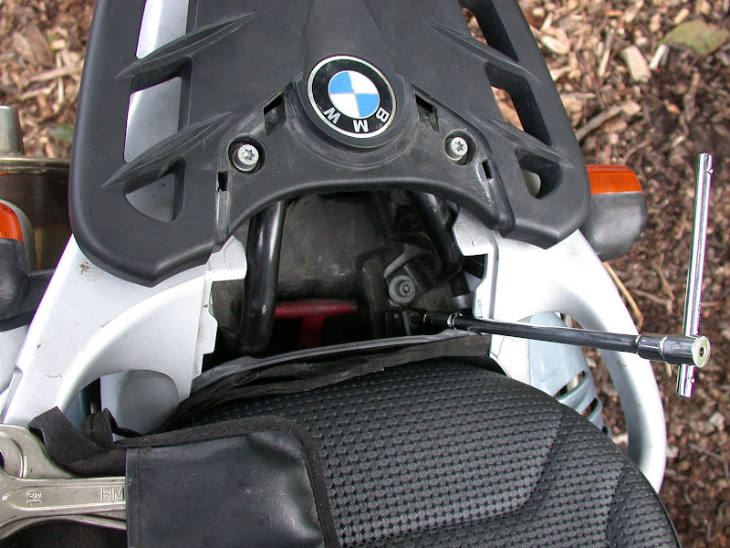

Originally Posted by JDLuke
It's been a while since I installed that piece myself. Seems to me that I had to move at least one small metal bracket out of the way in order to do the install.
I'll look to see if I still have the mounting instructions anywhere...
Does this picture help at all?
Yeah, that picture helps...quick questions --
1. Looking at the picture, is the right side screwed in where the turn signal bracket used to be? That may have been what you moved.
2. So then, is the left side screwed in, not directly across at the other bracket hole, but in the one hole closer to the seat than that?
3. Is the bracket in the back, underneath it, screwed in in front of the existing holes, or behind it? If it's behind it, looks like I'll have to relocate some wires, but that seems to be the answer. Still toying with it.
EDIT: Sweet, that was it. Moved both turn signal brackets, and attached #2 plate behind existing holes in space. Thanks for the help!
