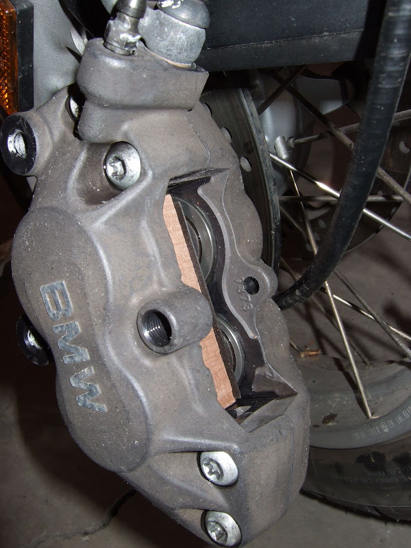

Then I installed the wooden shims in the calipers. The next two photographs show the wooden shims in the front-right caliper and the front-left caliper. I did not take a picture of the shim in the rear caliper.

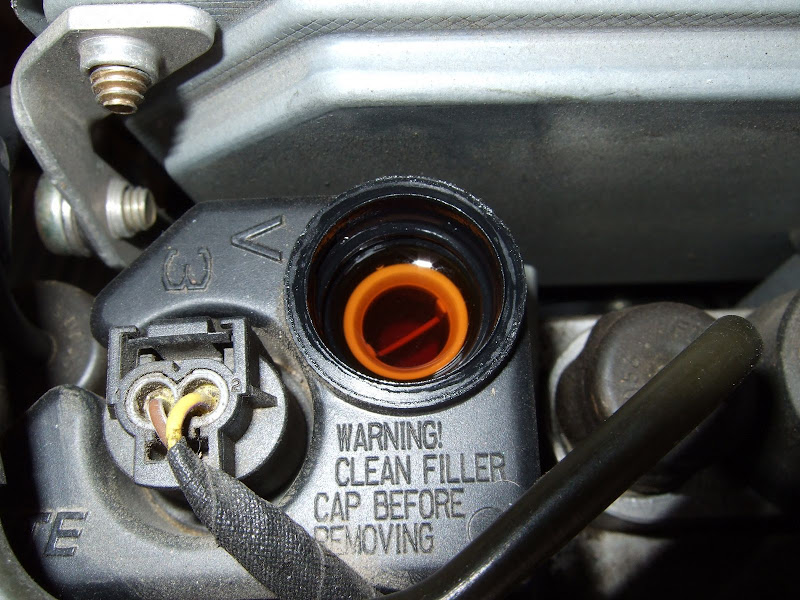

This photograph shows the condition of the iABS reservoir for the front calipers when it was first opened.

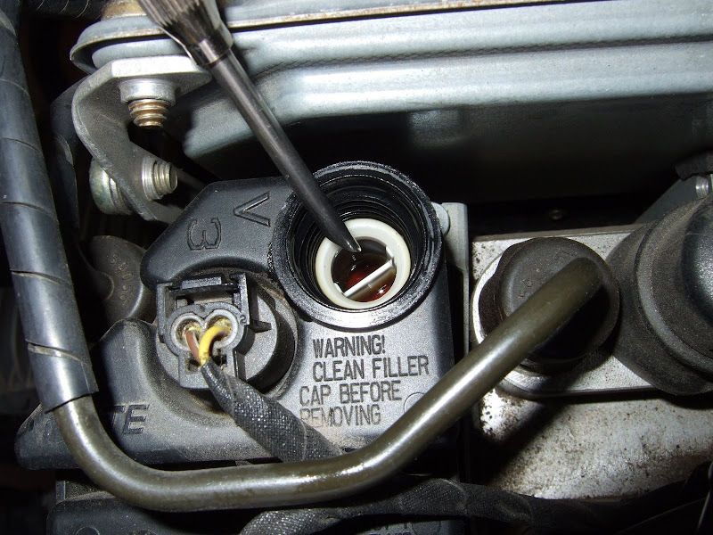

This photograph shows the "turkey baster" removing the used brake fluid from the reseroir.

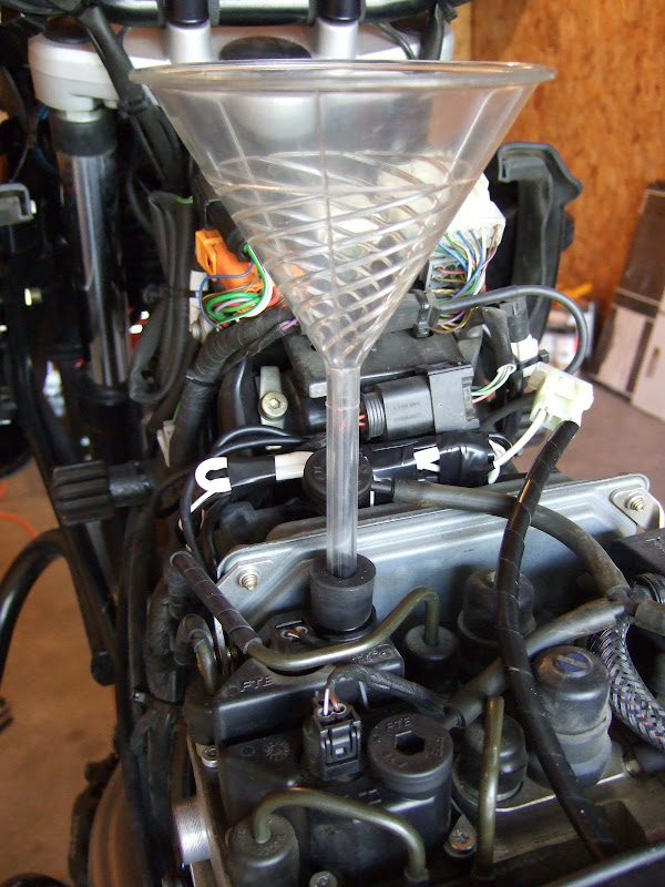

This photographs shows the funnel and rubber stopper installed in the iABS reservoir for the front-calipers. It is important that when you first fill the funnel with brake fluid, that you do it VERY SLOWLY as not to trap air in the iABS reservoir.
This photograph is a closeup showing the rubber stopper. It sealed well.

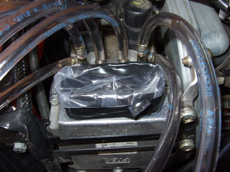

This photograph shows the tubing at the iABS unit when I was just about finished with the job. When you flush the hand-control-lever circuit you need to pull the lever very slowly at first, otherwise brake fluid will squirt out of the reservoir next to the lever. Regardless of how careful you are, this will probably happen a few times. Keep some rags handy.
This photograph shows the top of the iABS unit when I was finished. Some brake fluid leaked from the threads of the bleeders and some spilled from the tubing then it was removed from the bleeders, but the resulting mess was minimal and easy to clean up.

For some reason I thought the blocks go into the caliper the oether way. I guess they don't!
I've only made them but never used them.
