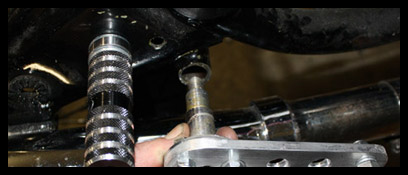

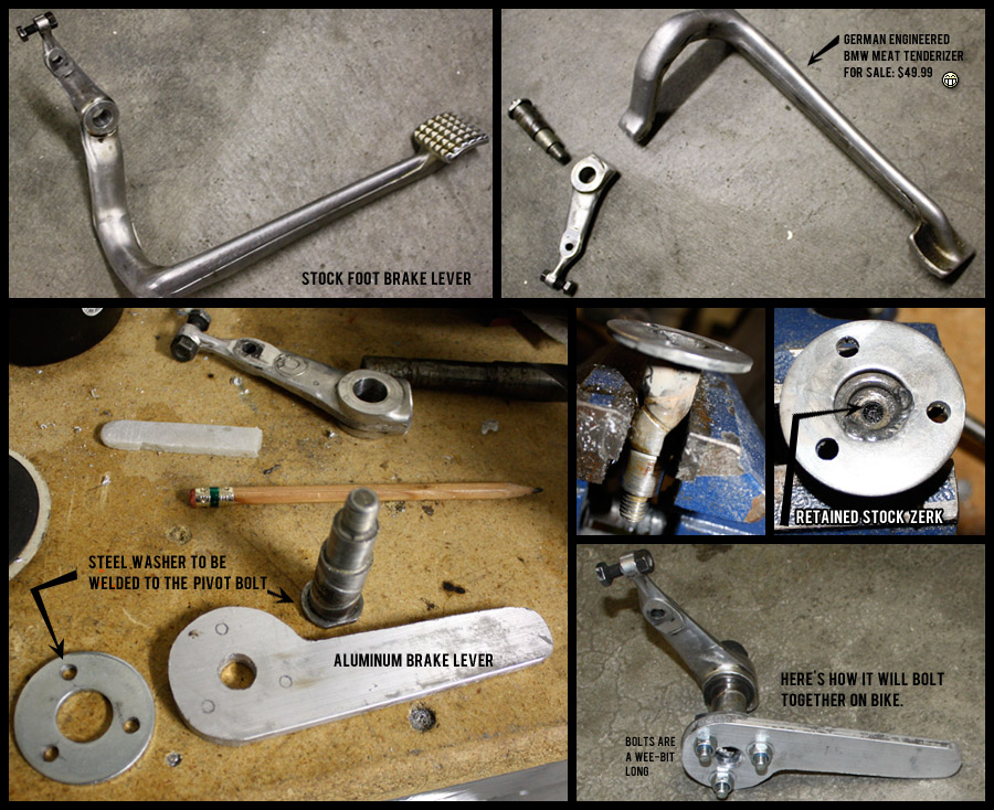

Rearsets: Left side
Rearsets are now installed. A little crude here-and-there but functional. I didn't get enough pics of this process but here's a link to what I referenced.
"CB450 Rearsets Done on the Cheap"
There you'll see several good pics of how the bearing was applied to the lever and how the completed lever was adapted to the bike (spacers, etc).
The bearing was a little bigger than 1” so it took a good bit of force to press into the 1” drilled hole. The aluminum wasn’t easy to cut but considering I used a jigsaw with a metal blade (wd40 for lube) it wasn’t too bad. A bench grinder cleaned up the edges and rounded corners. I then sanded and steel-wooled it. Finished pieces will be black with aluminum beveled speed holes.

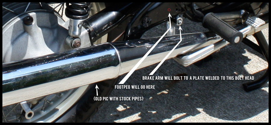

First off, here's the before...

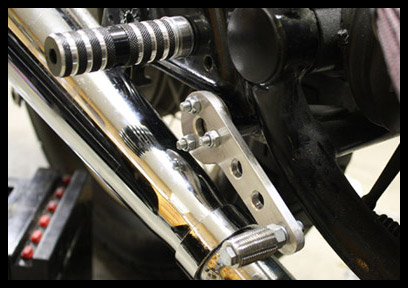

Rearsets: Right side
Here's how the right side turned out.
I was worried about losing the leverage the original lever had but it works great...shouldn't be an issue. Pretty happy with it. The finished lever will also be painted black with beveled aluminum speed holes.

I, too, was worried with the very fore-shortened brake lever that I ended up with on my R100 franken-rearsets:
I used the same stock pivot point, but had a rudimentary pedal from the po, which I used and then simply put a /6 left footpeg on, backwards... it has worked fine!

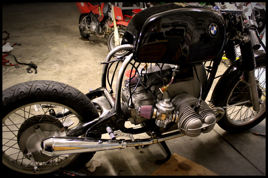

Here's a full bike view.

hey man, nice work!! Question: What kind of welder did you use to weld the bracket on the shifter arm? Did you have any trouble welding that? I still need to do something similar.

I use a Lincoln Weld Pak 100 Mig with flux cored wire for everything. Picked it up barely used for $170.00 about 5 years ago. Love it. It works great for thin stuff but wouldn't want to weld steel over 1/4" with it.
