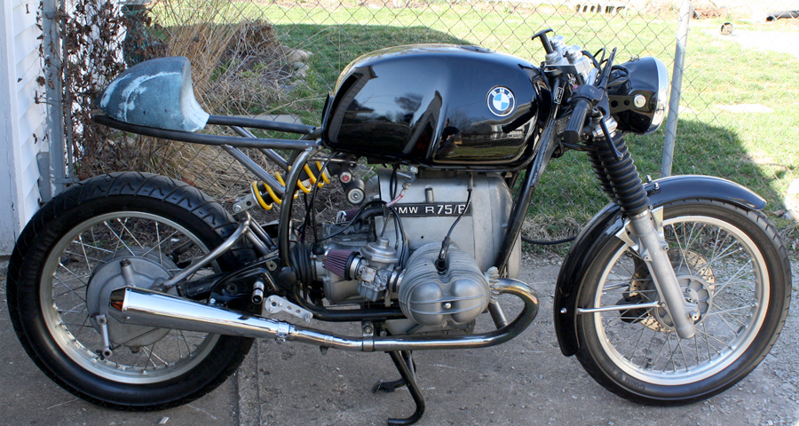

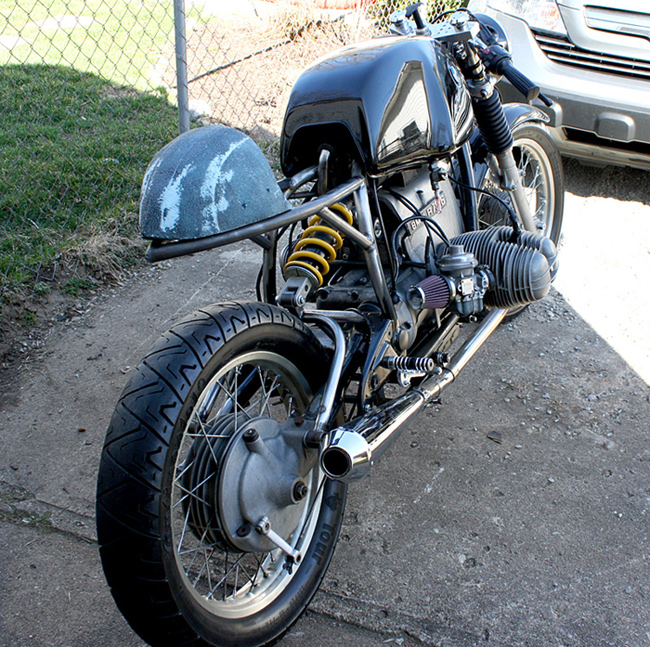

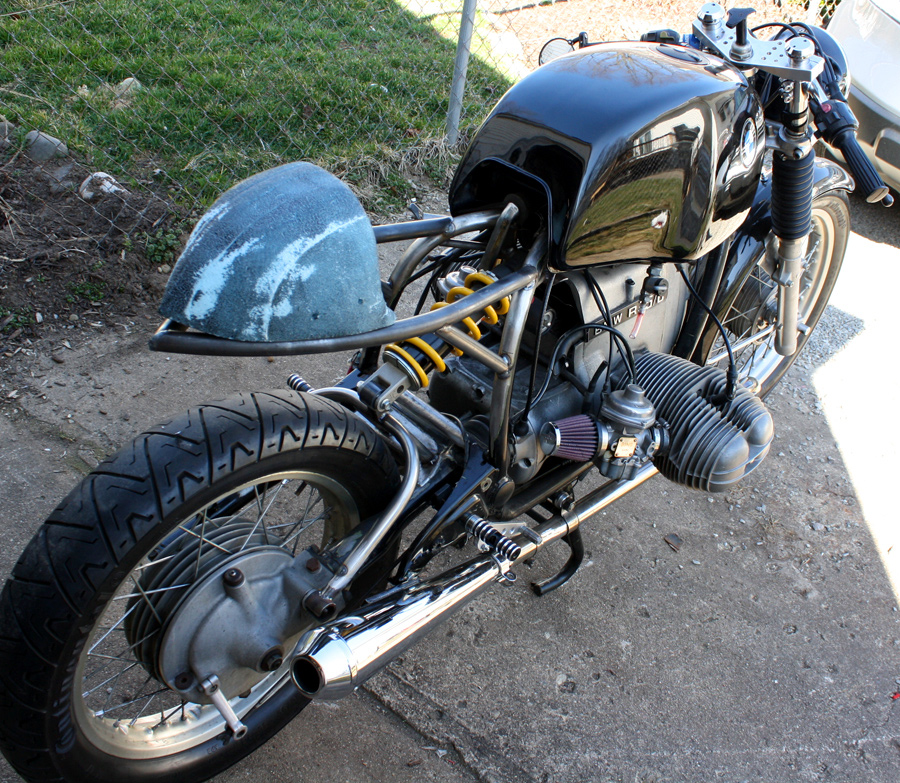

Old 03-17-2010, 07:40 PM   #62
sparkymoto OP
learning a lot here
sparkymoto's Avatar
Location: Indy
Oddometer: 188

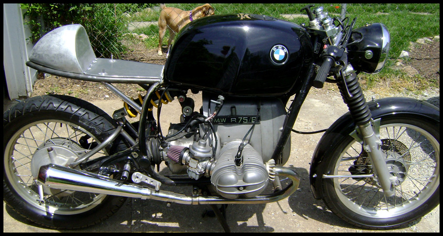

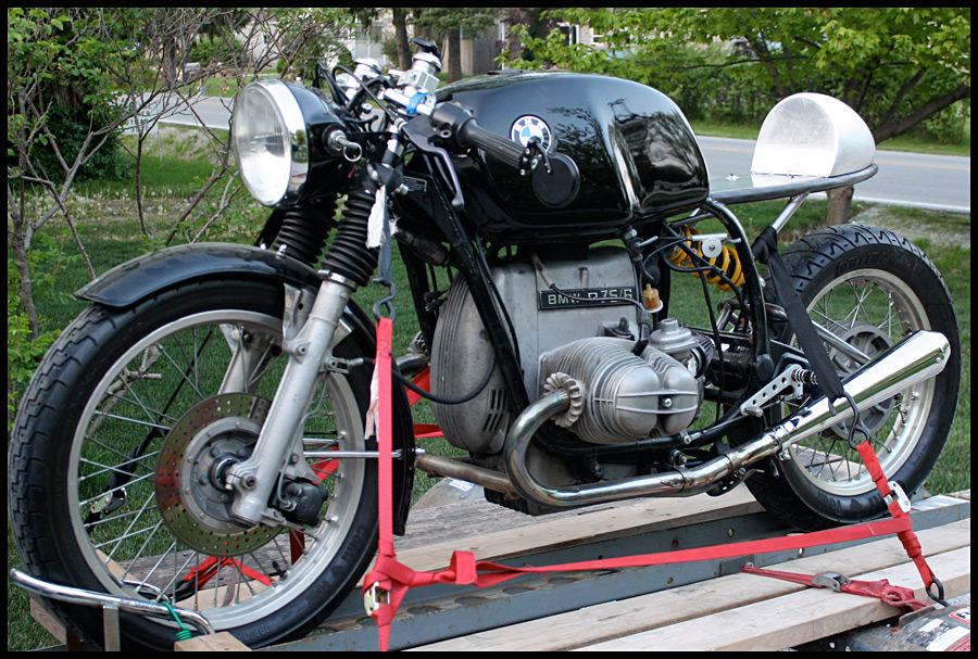

Progress!!
More of the upper rear frame is tacked up so we pushed the bike out of the garage to see how it's all coming together before final welding. Man, this is getting really fun!
I'll be scrapping the Conti tires and the front fender will be trimmed down a bit.

Old 03-17-2010, 09:54 PM   #63
sakurama
on an endless build
sakurama's Avatar
Joined: Oct 2004
Location: NYC & PDX
Oddometer: 1,211
Nice job so far. I'm going to keep checking in on this one. Careful on your tire selection - it looks close on the new swingarm brace and tires grow at speed. That can be a scary thing to discover when you wind it out the first time.
Can't wait to see the tail done - is it going to match the subframe and come to a point? Really liking that.

Old 03-18-2010, 08:08 AM   #64
sparkymoto OP
learning a lot here
sparkymoto's Avatar
Location: Indy
Oddometer: 188
Gregor
Hey, Gregor. Thanks for weighing in. MUCH respect for your projects...been ogling it for years...and the photography work, my goodness.
The bracing is close. I was "hoping" the tire wouldn't distort enough to make contact and had planned on using Avon AM26 Roadrider 120/80V18. Current tire is a ContiTour 120/90. You think the /80 Avon will reduce the rub-risk a tad?
The rear point on the frame was originally going to flip up a little at the point but I'm going to leave it straight. Love the simple straight back line now. So, yes, the tail piece will come to a point and all fit flush with the tubing. Here's a aluminum tailpiece Cliff made for my brother's W650:

Old 03-18-2010, 08:42 AM   #65
rkatapt
Indo-Kraut
Joined: Jun 2008
Location: Dallas, TX
Oddometer: 257
Send a message via MSN to rkatapt
That 120 rear tire must be awfully close to the swingarm. it seems the 110 is really close. I am getting tires this weekend and am going with a 120 as well since I saw you were able to. You didn't do anything special to the swingarm did you?
Ironic you mentioned the Avon's cause I am looking at those or the Dunlop GT-501's.

Old 03-18-2010, 09:10 AM   #66
sparkymoto OP
learning a lot here
sparkymoto's Avatar
Location: Indy
Oddometer: 188
Looking fantastic...
Thx. I like the GT tread pattern for sure. Let me know or post up on your project thread if you go through with it this weekend. I'd like to know how that works out. I suppose it would be safer to go 110. the ContiTour is less than an 1/8th from the drive shaft housing :) Google "advrider tires for airhead" for more opinions. Good luck!

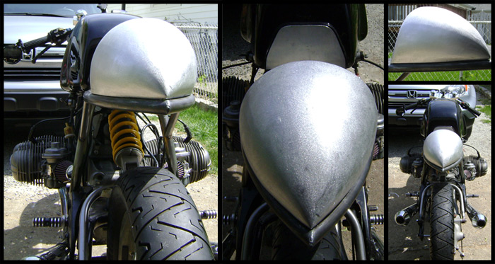

Old 04-04-2010, 06:47 AM   #69
sparkymoto OP
learning a lot here
sparkymoto's Avatar
Location: Indy
Oddometer: 188

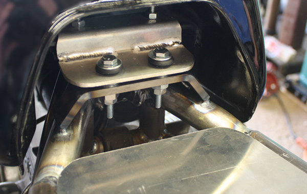

quick update
The seat pan is coming along and the new tank mounts are fitted. The rear tank mount was raised about 1.5" which makes for a better stance and body lines. Pics...

Old 04-04-2010, 07:18 AM   #70
locksmith777
locksmith777's Avatar
Joined: Nov 2009
Location: Worcestershire, UK
Oddometer: 59
A great thread , going to build one within the next yr or so but not decided what bike to use yet , will either be a Airhead or Honda CX unless i get any other ideas ...........Keep up the good work.......

Nice I like the tank raising idea. Guess you'll lose a little distance as far fuel pooling to the front of the tank. You'll just have to pop wheelies to get it back to the petcocks.
What do you plan to do with the old air box area? Most of it is filled with the shock, but are you going to make a cover for it? I have a set of UNI air cleaners I ran for a while, but I hated the way the void looked without some kind of cover.
Also, how do you get both wheels to touch with the center stand down?

Old 04-04-2010, 09:28 AM   #72
sparkymoto OP
learning a lot here
sparkymoto's Avatar
Location: Indy
Oddometer: 188
Wheelies. hmmmm. I'll have to try that I think fuel will still reach petcocks fine...it's not too drastic of an angle change. As far as the area around the airbox...not sure yet. At this point, i want to just cap it of with aluminum plate. Have other ideas but will wait for the final thought to hit me after staring at if for a few more hours
The bike pretty much sat on both tires when on the centerstand when I bought it...on very level surface it would have a little 'air' under the front tire. I let the swingarm down about a 1/4" tho when we mocked up the new mono shock set-up. I also slid the fork tubes up through the trees about an inch.

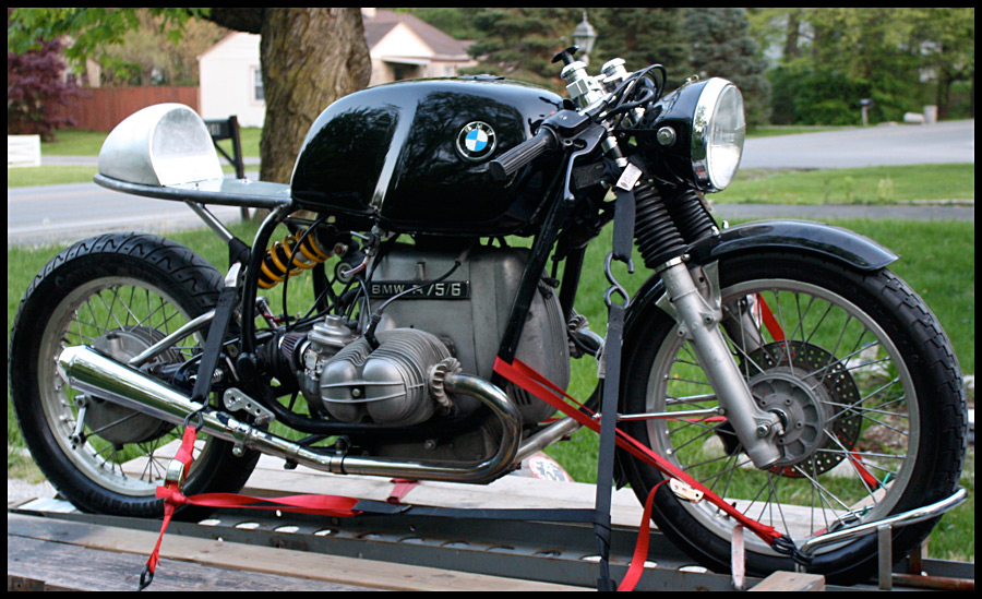

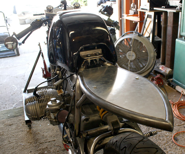

Old 04-22-2010, 08:06 PM   #73
sparkymoto OP
learning a lot here
sparkymoto's Avatar
Location: Indy
Oddometer: 188
update
Well, great news from Cliff. The tail section is done! All the tail piece shaping and seat pan is final and fitted to the bike. The flush front "tunnel" plate reeally cleans things up eh? Here are a few pics fresh out of his shop.

Old 04-22-2010, 08:39 PM   #74
sparkymoto OP
learning a lot here
sparkymoto's Avatar
Location: Indy
Oddometer: 188
Back Home Again
The bike is now back in my garage Lotsa fun ahead getting this thing ready for the season. After staring at it for a few hours, wondering where to start...I hooked up the battery and fired it up. The first ride around the neighborhood was a blast. So, of course, a few more items on the "to-do" were bumped to "NEXT season."
