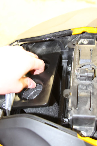

Three little holes!
Originally Posted by SCVGS View Post
I got some free dyno time today and found that the little foam plugs that Uni gives you as prefilters cost me 3.2 peak HP! Remove them and its equal to a stock filter. Drill three 1" holes in the airbox lid and gain 2.6 peak HP and the torque rises a bit below 5K RPM. YMMV
At some point I lost one of my prefilters so I ended up throwing the other one away. When I went to go and clean the filter I had found the other one had been sucked into the snorkel. I decided that I would follow SCVGS lead and drill three 1" holes in the air box cover and then cut up the prefilter into three pieces and stuff them into the holes. I haven't had it on a dyno but it sounds much better like is not gasping for air anymore. I didn't oil the plugs I just couldn't have open holes in the airbox.
