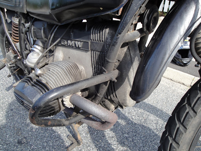

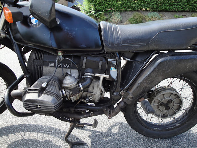

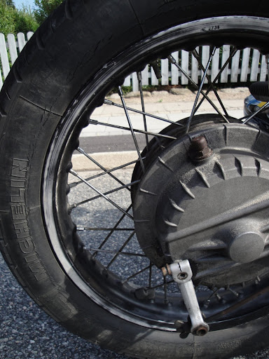

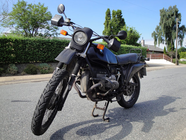

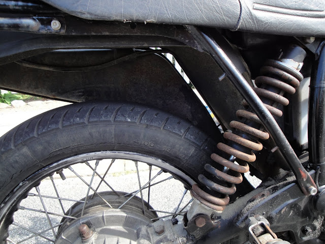

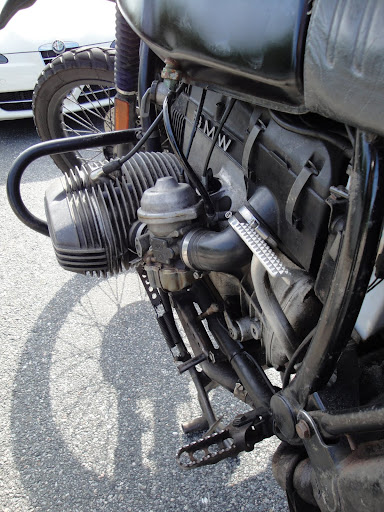

Hey mates,
checking out this R65GS on tuesday, not familiar with these bikes yet, so I am going to post a few pictures. Would appreciate if you could give me some pointers on what to look out for. Missing/Unoriginal parts etc.

Missing side covers.
Mirrors looks later model or 'K'
Rear pegs may be stock but look like R series road bike.
Only one I ever saw had to Denfield round rear pegs same as R80G/S
Main pegs came with a rubber insert, removable, most owners did.
Gear shift lever had a rubber cover.
Hand guards are an add on but genuine accessory for the model.
Kick start lever is sticking out too far indicates damage in the mechanism.
Finish looks rough but the rubber bits all seem to be in good condition, fork gaiters dust covers, even the reset button on the odometer seems to have survived in tact.
The seat cover is worn at the front pity.
There are screw out stand off stoppers under the seat to stop this
Luguage rack is genuine and often came packaged with a panier rack, right side only no bag might pay to ask if there is one lying arround.
Otherwise it all seems to all be there.
23,000km looks rough but genuine parts through out.
Bike looks maintained but unloved.
Is it ex-military?

So I went to check it out.
It started up ok, had a sticky chokespring on the righthandside. Pulled ok I guess, never tried one before. On downshifts coming up to intersections there could be some grinding of gears if I wasn't "determined" enough I think.
Fussy starterbutton, it worked, but you had to be sensitive, corroded exhaust. Cracked tires.
Initialcost was 22900,- DKK, when I asked him he said 20000,- DKK, but that is still alot for something that needs this work I think. Wont pass the inspection with those tires or that exhaust. Did 120km/h on the highway, which it could hold fine. Throttleaction was not as "loose" as I would like to.
Wadda ya think?

I see a beach bike with TONS of potential for a horrible mess. It's a great model BMW but don't get caught up in how awesome a bike it is vs. how much trouble it's going to give you with the amount of wear that I can see just in the pictures.
You'll easily double your cost in bringing that thing back up to good shape.
That's the most negative I've been about BMW, actually. They are super easy to work on and amazing bikes, but I'm weary of bikes near salt water/sand because that stuff can ruin a bike.
