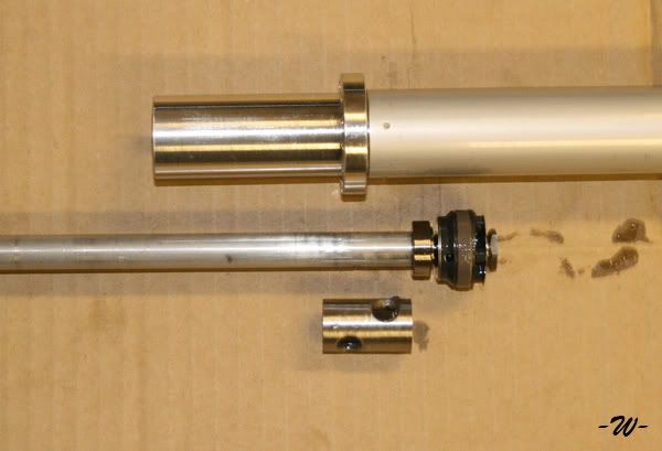

Oddometer: 193
Originally Posted by B-B View Post
So the donor forks can have more travel, and still work In the F8 fork tubes, with the same stock ride height? I'd like to keep the stock height, but most of these coming off dirtbikes seem to have more travel. Also, is there a way to add preload adjustment (maybe by using a cap that supports it, like RaceTech caps) or is this determined by the donor internals?
F800GS has slonger fork tubes than normal "racing" dirtbikes, even though it has 230mm of fork travel and dirt bikes have 300mm.
This means thst if you put Aprilia RXV, BMW G450X, Beta, Husqvarna etc.. Shiver 45 internals in F800GS tubes you will have about 270mm of fork travel. You can limit that amount just by putting a spacer to the rod like this: http://i638.photobucket.com/albums/u...Rod_spacer.jpg (spacer is the lowest one).
So with those internals you can have what ever travel you prefer up till about 270mm.
-W- is offline   Reply With Quote
So if I read that right, its the total stroke of the piston being affected only but not ride height? I saw you had your forks mounted higher initially to compensate for the increased travel which is why I ask.
it sort of depends on what you want. Keep in mind you are reusing the stock BMW fork tubes. If you want more travel you can just use the donor internals. BUT if you do that you will want a shock for the rear to match the longer travel most likely.
I chose to have my suspension guy add the spacer so that my forks stay at stock length travel. They are mounted exactly like I had them before the change with the tubes poking through the tripple clamp to the first line or hash mark.
Of course the ride height will be increased also if you don't move the forks in the triples.
My forks were originally mounted higher for a short while to compensate the increased travel until I got the custom rear shock. Now they are at their original place (and I also got 250mm of rear wheel travel).
