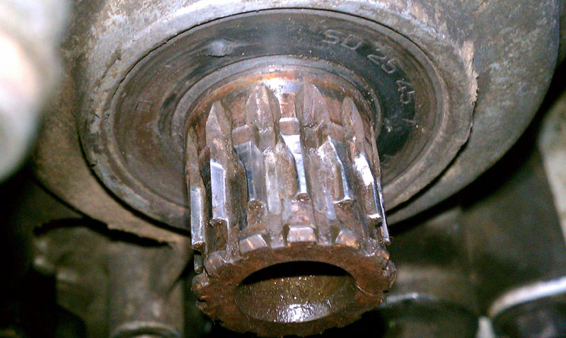

Do First? Get an XRR650 front sprocket so you dont wear out the countershaft
Whats wrong with the stock?

Its narrower then the XRR Sprocket, and your countershaft will end up looking like this
