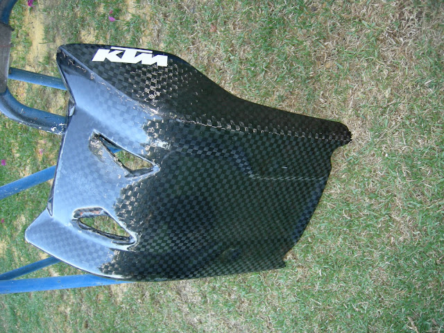

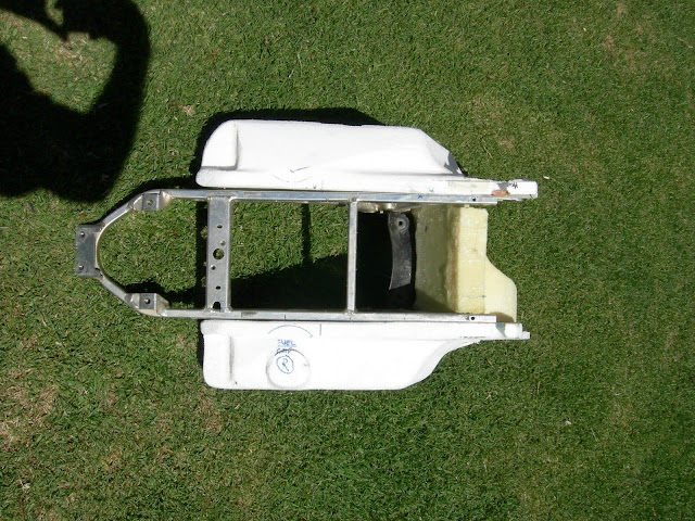

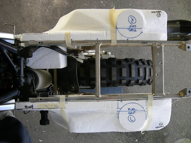

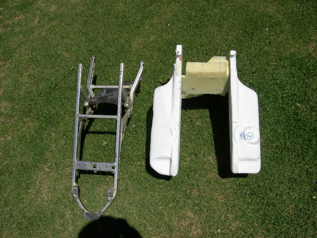

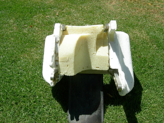

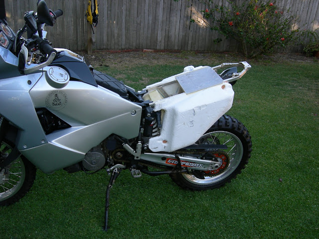

posting the pics of the tank mockup from pete's link (hope you don't mind it, Pete640), nice work btw
bashplate

im lookin at this and the bulb comes (dimly) on that with these tanks I will also need a Africa Queen's or GPR like exhaust system since the tank takes up the space that is normally where the mufflers reside.....
That's really the only downside for me (although I guess it isn't for many), mainly due to cost. Looks great though, and I'd love the extra fuel, obviously. I'm interested, subject to total cost. Any need to beef-up the subframe (perhaps I missed this)?

Oddometer: 2,238
I think that the availability of the GPR exhaust system makes this viable now.

OK - hopefully I can answer all of the questions;
Replica tanks: - No the subframe wont need reinforcement, ive carried more than 50kg of luggage and gear over 1000s of kms of hellish corrugations and its fine. I expect the unit itself to weigh around 2kg, obviously the fuel will add weight but thats the purpose of the tanks. Im expecting 20+ lt capacity, so 44+ integrated. Itll fit the 990's, but not with ABS as this is where the unit is housed. Sorry.... The 990S doesnt come with abs I think - I'll have to look at that..
Yes - I have the GPR system and its made to fit. KTM twins just had them on sale for around $870US I think - bargain. May still do. The centre tank "link" does require removal of the original X over, and the 2-1 wont fit. Maybe I should become a GPR dealer
Pillion pegs are in, no moulded handles, modified OEM units that will still support the luggage plate. Also by recessing the pillions I can fit my KTM luggage racks with a bit of modification (more on that later).

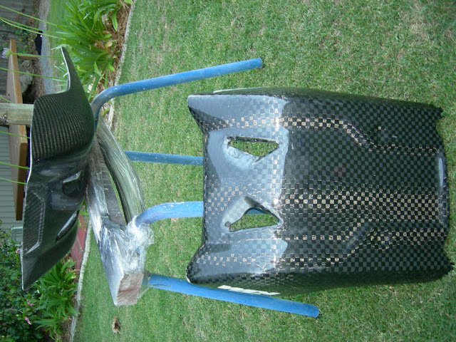

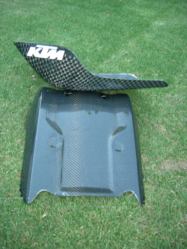

Bashie: - its a multipul CF/kevlar laminate thats vacuum infused. Holes in the front aid airflow around the battery/rectifier/some low headers. Being as wide as it is it deflects just about all of the crap from the front wheel, infact my boots stay super clean all the time, especially riding in the rain.
Did I mention I do a screen as well??? (incorporating a foil and front vent to reduce that fuc#@g turbulence)... more details soon.

Forgive if this has been talked about already but will the subframe be able to handle the weight of tanks/gas AND some luggage?
I'm not talking about hard side bags here but something in the line of a Giant Loop bag or. . . . . .?
Yep, I've done a few trips loaded with gear and with 30 extra liters of fuel (loaded high and far back on the rear rack) and never had an issue. A giant loop and this config wouldnt be an issue (weights is held low on both the proposed aux tanks and the gl).
