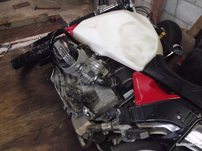

No progress on the RS. Flywheel bolts & a few seals arrive this week, but the crack in the gearbox is an issue I've yet to find a solution to. Possibly I'll need a second hand cover & will need to reshim the gearbox. This being the case, too expensive to deal to now. I'm likely to button everything back together, & wait until there is less to do elsewhere.

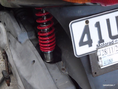

MANDY'S GILERA RUNNER:
Is due for a warrent. At the last inspection Richard said the corrossion was a concern. So I've painted the shock which smartens things up. The powdercoating let go fairly early on (the shocks only a couple of years old), and the spring was very rusty underneath the residual powdercoating.
Next weekend I'll tackle the forks, which have also lost their powdercoating (bloody Italian powdercoaters ), & have also lost their dampening.
The Frame could do with a going over, but given Mandy uses the bike all the time, its hard to take this off the road. I'll coating it with the Lanolin anti rust spray coating. The paint is holding up okay (considering Mandy never garages the bike) but has some surface rust.

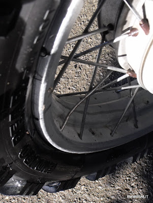

Originally Posted by BMWRSNUT View Post
So are the rear spokes supposed to have a kink in them like this?
Ouch. How’d you do that? Just catching up after three weeks overseas... Hopefully I have a refurbished gearbox to pick up this week!
Sutherlands Hutt 22/05/11. Either the steep stream crossing where I got temporarily stuck, or Cnut Hill. EddieB's footage. Bear in mind the state of that front MT21 in the muddy sections in particular, and you'll understand why the outriggers were out a bit..
