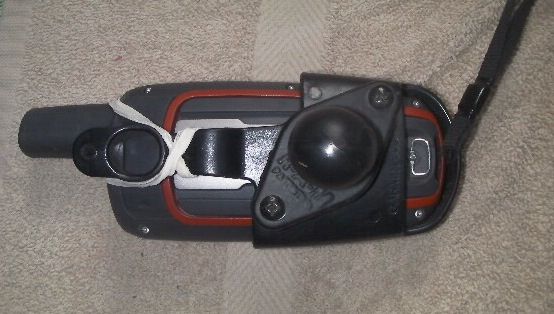

Mounting the 62 on a bike:
RAM does not have a mount yet for the 62 but the 60 mount works reasonably well. Garmin has gone away from the button on the back which RAM used as part of their mount, so a complete redesign is probably necessary.
But when I bought my 62 I needed something to hold it so we tried the 60 mount and the bottom of the 62 fits snugly into the holder, and a heavy duty elastic band holds the top in very well. In about 1500 kilometers of motorcycle riding so far, it has not come off once. I do have it tethered to my handlebars, though, just in case.

Here's how the RAM 60 mount fits the 62:
Works well enough, for the time being, until RAM makes a 62 mount.
