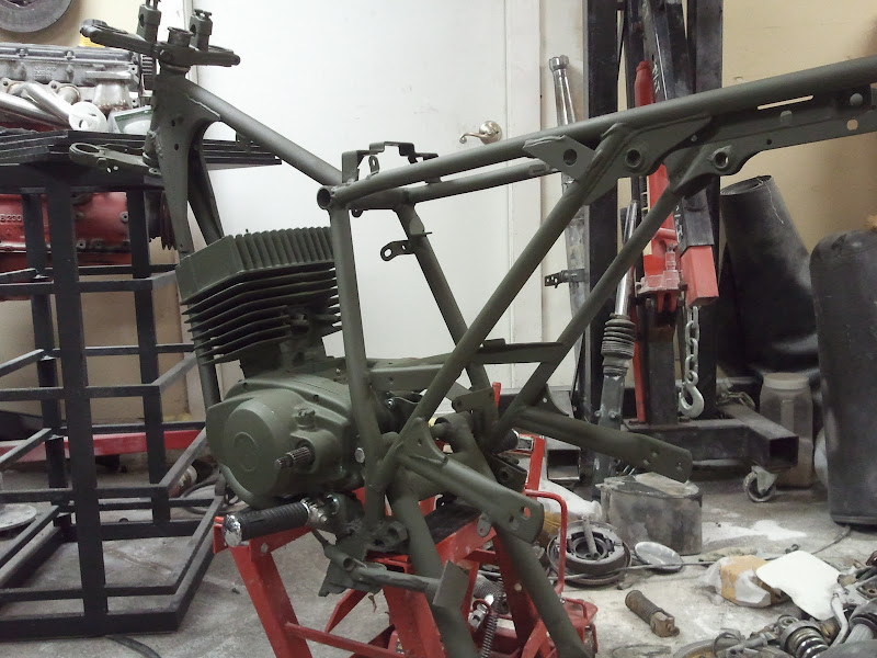

I have a long illustrious history of doing stupid things. As a child, it started with things like jumping off of the roof holding an umbrella to see if it would slow me down (it didn't), and jumping my mountain bike into immovable objects. I was more concerned with the jump itself than what was directly in the landing path. Once it was an apple tree, another time a closed garage door.
Later, while living on Nantucket, the harbor froze, so I did what any wicked smaht brain-box kid would do: walk on it, with no adult supervision. Fell through. Cold, etc.
I've fallen off of my house, towed more than one 5000lb vehicle with a 4 cylinder S10, been bitten by a rattle snake, driven a decrepit '84 Mitsubishi Starion LE Turbo to L.A. and back in one day, and last but not least, imported 3 Minsks into the U.S.
I bring these things up because I think I have just raised the bar.

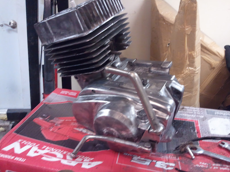

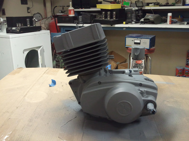

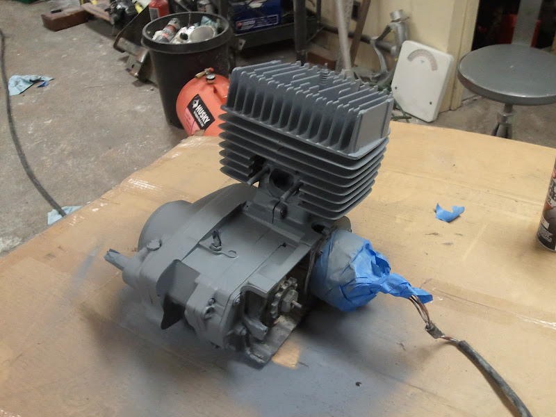

A few days ago a friendly gentleman said I should try soda blasting my parts rather than using a wire wheel. It seemed like a reasonable idea to me, so I borrowed a blaster from my friend Deniz, went to Costco and bought 27lbs of baking soda, and went to work.
I started the project outside, but after less than a minute of blasting I noticed the immense white cloud of dust going into my house, out into my driveway, and worse, over into my neighbors house. Being the polite gentleman that I am, I decided I should find an alternative to coating the entire neighborhood with a fine white powder.
I remembered painting my old car trailer in my garage some time ago, and that worked fine. I stripped it all down to bare metal, resprayed it, and then when I was all done I just blew all the dust out with compressed air. No problem...
Having put a good 9 seconds of thought into this decision, I dragged my air line back inside and went to work. Dust mask, safety glasses, hearing protection, compressor thumping away trying to keep up. Soda blasting is awesome. It strips off paint, rust, and that strange shmegma made up of 2-stroke oil and fossilized dust without hurting the aluminum, or even the seals.
This concludes the cheery bit of my soda blasting odyssey.
I was having so much fun soda blasting that I didn't really pay attention to what was happening to my garage until I ran out of baking soda. When I had a look around I realized that this was nothing like when I repainted my car trailer. Stripping the whole trailer probably created 60oz of dust, whereas I had just distributed 27 pounds of baking soda evenly across everything in my garage. Oh boy...
Then when I went outside I realized that I had a pretty serious nose bleed; apparently a fair amount of baking soda was getting through my flimsy paper dust mask.
After taking a good look around I decided that my garage was such a wreck that I might as well just go buy more baking soda (and a real respirator) and finish the project, it wouldn't get any harder to clean up.

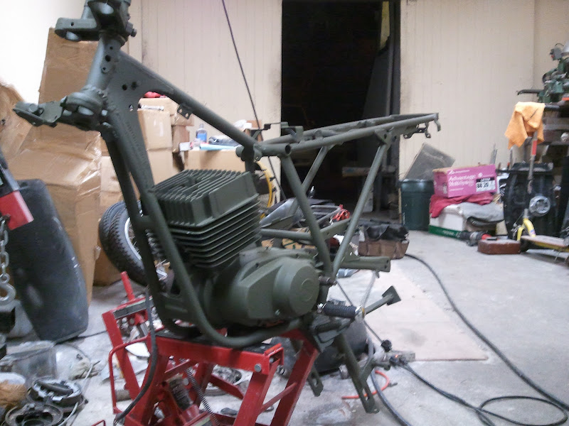

So the next day I finished the engine, then lightly blasted everything else. I used 40lbs of baking soda, on top of the 27lbs from the previous day.
NOW the garage was ruined. It was more than an inch thick in places. Even though I had closed all the drawers in my tool boxes and closed the doors of the chemical cabinet, they were both full. It occurred to me that it would probably be easier to just move to a new house and forget this ever happened.
On to the good part!
Everything came out great. Here is the engine in primer

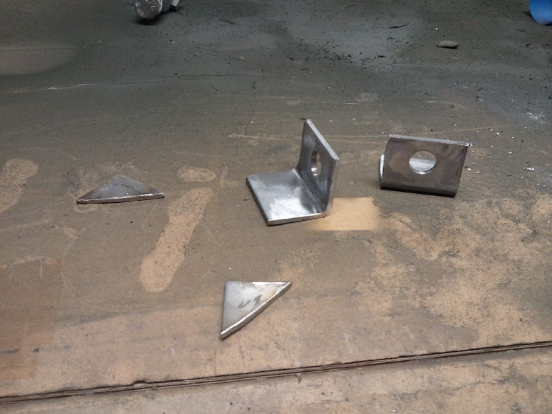

While waiting for the engine to dry I made some brackets for the new foot pegs

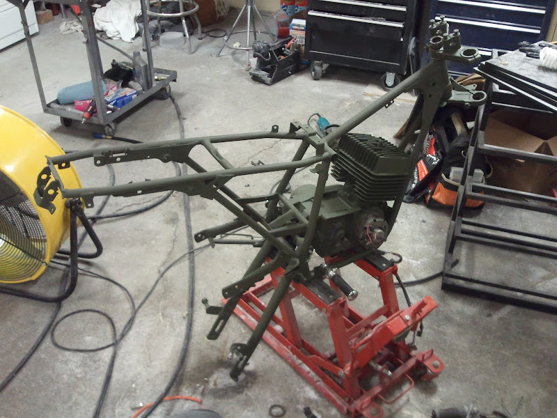

Frame with engine, swing arm, and foot pegs!
Things are finally happening
I should be able to have wheels on this thing reasonably soon...
