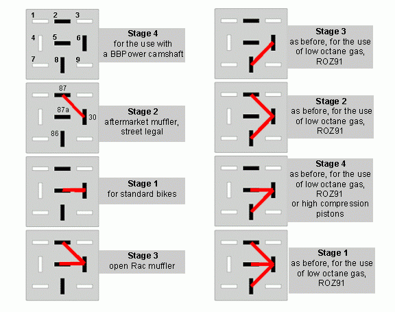

Given all the symptoms you reported, and that your IICE Air tested good over here, it does seem possible that an aftermarket EPROM is installed inside the Motronic ECU on your bike.
Here are a few Cat Code Plug configurations for aftermarket EPROMS.
This is the BBPower coding chart for an 1100.
This is possibly the BBPower chart for an 1150.
Another aftermarket EPROM chip. Manufacturer unknown.
