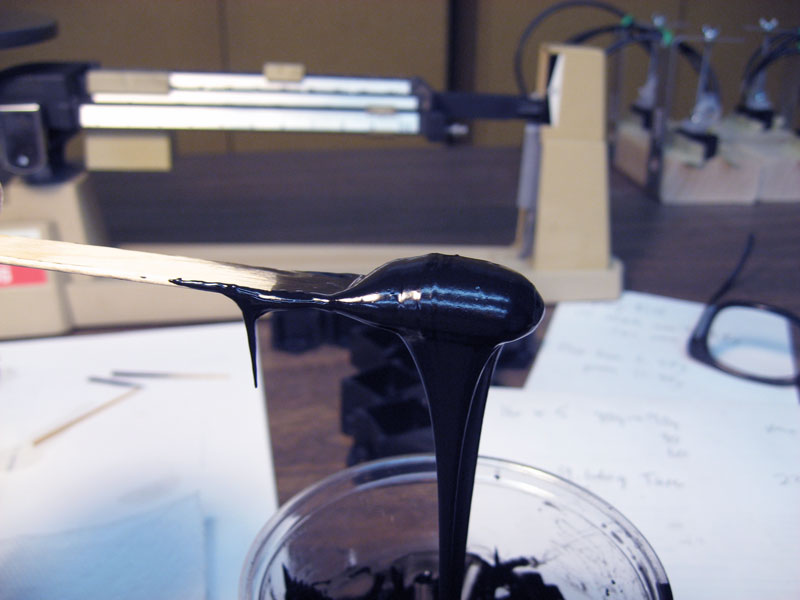

Without getting to technical, it means if you throw it at the wall it sticks.

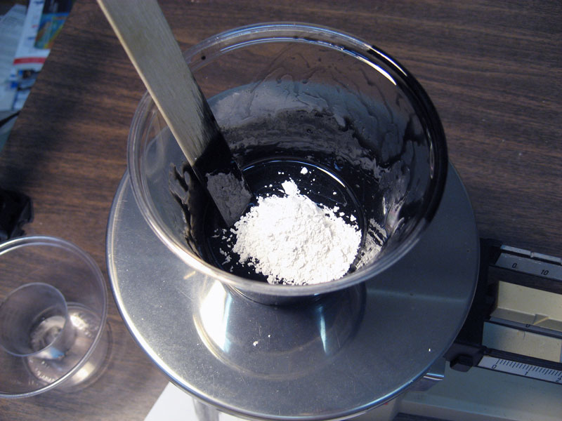

Here's how to make it. Get some Calcium Carbonate powder and mix it into the epoxy.
(For reference, that's a tongue depressor.)
Don't sneeze.
This particular epoxy is fairly low viscosity. Similar to light weight gear oil.
If you look close, you can see the fluid sheeting down the walls like red wine.
Vary the mix ratio to suit. In this case I used 1.5:1 powder to epoxy, by weight.
That's a lot more Calcium Carbonate powder than you see here.

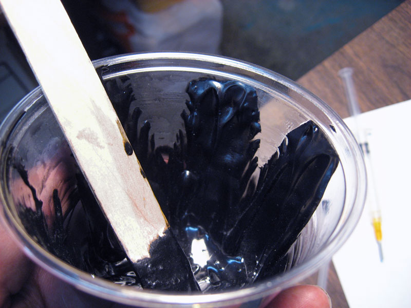

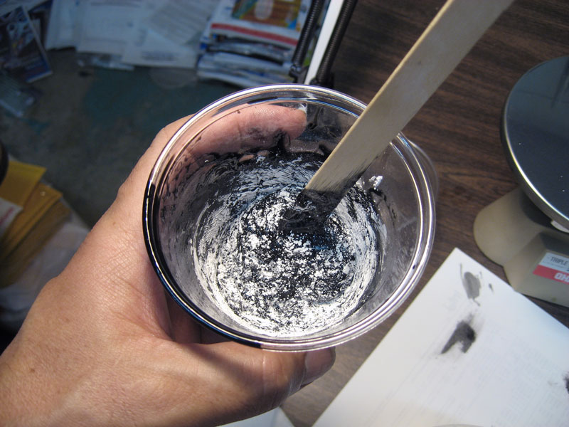

Mix fully.
You'll end up with something like this.
At this mix ratio it sticks to the wall and stays there.
Get a big scoop on the tongue depressor.
Yum!
It pretty much stays put like that. It's a little like bread dough.

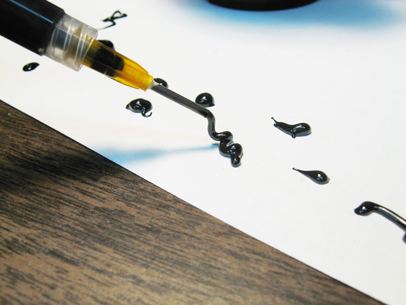

But wait, this 'bread dough' stuff needs to dispensed through a 15 gauge syringe needle! How is that going to work?
That's a 3cc syringe, and only a 0.060"/1.5mm needle bore diameter!
The magic of thixotropic fluids. It flows relatively easily when subjected to a shear force.
