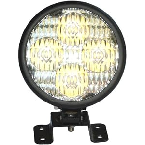

Originally Posted by Mollygrubber View Post
How about this lamp system?
4 x 10w LED's each, shipping weight 1.7lb
3200 lumens, draws 3 amps.
http://www.amazon.com/gp/product/B00...n=&s=&v=glance
how to fasten it? to the frame or fork tubes?
Ben

Originally Posted by Motorfiets View Post
how to fasten it? to the frame or handlebars?
Definitely NOT to the bars.
why?

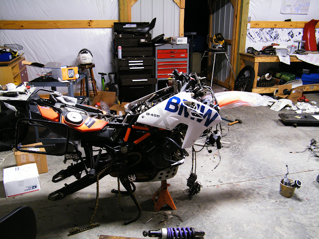

no pictures yet.... but the bike is stripped to the frame, engine and swingarm.....
removed the tank, forks, fork clamps, rear shock, air box, fuse box, mudgaurd, fender, front headlight including bracket..... its a clean slate!
started installing - hydro clutch, KTM brake resivour, single high front fender, pro-taper bars,
problem is...... I gotta loose cam chain.....
for sale currently is anything I take off I don't need
why?
when I saw bars I mean the fork tubes.... sorry for the misconfusion
Fork tubes would be marginally better. IMO, frame mounted is superior because it points the way the bike is going. The bars and forks don't always do that. And they move around more. Frame mounted lighting is more stable.

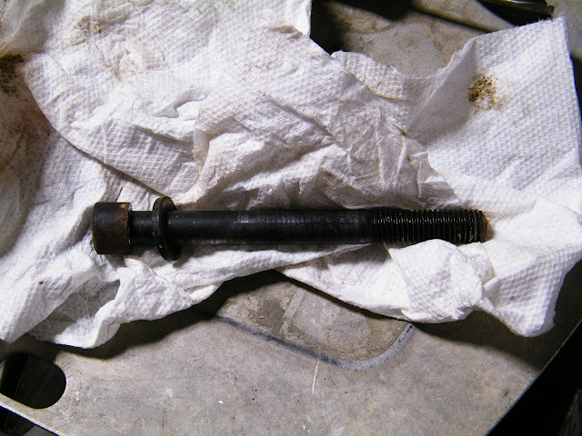

rear shock bolt

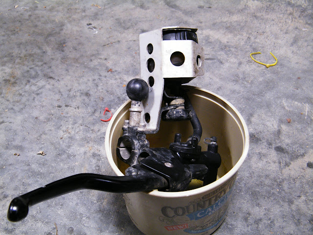

anyone wanna buy this?
or this?
how about these junk things as well?
oh! and this too..
don't need these either!

I'm keeping the scotts.... the bracket however wont fit WP suspension
