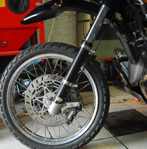

Finally took the new front end for a test ride today.
Pissing down with rain and very cold- not the best testing conditions for bitumen and a bald rear and full knobby motocross front tyre
anyway, it was good fun- It was not a serious test, as things are still quite literally cobbled together- but it was just a proof of concept sort of ride as a kind of reward.
[/IMG]
Note the 'ึhlins Yellow' electrical tape holding things together After almost having to cut the last handgrip off that I slid halfway onto the new(old) throttle tube, I decided on a temporary grip- a rag wrapped around and electrical taped on
I have no headlight set up, nor front indicators so all I could do was run around my neighbourhood hitting speed bumps and testing the brakes and whatnot, hoping not to get in trouble by the 'boys in blue'
Initial thoughts are
VERY NICE.
I can't say I practiced turning much, but it hits bumps well.
With unshortened forks it is bloody tall- and I can see why people are leery of loosing any more turning circle. It is tough enough as is.
Aside from putting in new .6 kg springs, plus an Ohlins on the back sprung to my bike/weight, I haven't done any actual 'setting up' of the suspension- I haven't shortened forks (have just slid them up in the triples as far as I can) nor set front or rear sag, nor even fiddled with the reb/comp adjusters on front or rear. Hell, I haven't even changed nor checked the volume or weight of oil in the forks- there is some in there, that is about all I know.
Despite all this, and the problem described below, the suspension feels remarkably nice and if I had to I would happily take it for a ride in the dirt as is.
I couldn't hit a speed bump too fast- big hits seemed excellent. Undulations in the road seemed a little odd- more about that below.
Anyway, there is a lot to work out.
On old pads not yet bedded into this very lightly used 320mm rotor, the brakes are simply excellent. Given the knobby tyres and the wet, it probably isn't saying much, but I can lock up the front wheel with two fingers... a little too easily
I definitely won't be needing to upgrade anything brake related. I am happy.
My funky home-bungled caliper bracket(s) performed flawlessly. I did a lot of laps up and down my street hitting or riding the brakes and just watching the bracket and caliper assembly and disc the whole time and it is all solid as a rock.
I got the alignment right and by filing out the caliper bracket a little and rotating the caliper a little bit further around than stock (at more of an angle to the disc) I think I might have a teeny bit more rotor under the pads than Jenna's slick HE setup with the same disc. I'm sure it doesn't do a bit of difference though.
One thing that I am not happy with, and am a bit confused about, is around the first few inches of travel I am getting a bit of stiction. Basically around the whole area of travel from full extension- static sag- race sag and the bottom area of brake dive.
For example, If I hit the brakes I get some brake dive, then to some extent it just kind of stays down there. If I hit the throttle and lift the front a bit, then the forks extend again.
With static sag it is the same. Lock the front brake and push the bike forward and back and the suspension 'settles' in quite different spots.
Sticky stiction.
I suspect this is the primary reason that big hits feel good and small undulations in the road felt funny.
I'd expect a bit of stiction, but it just doesn't feel right.
I've goofed up a couple of times with the axle and spacers- I think I've got it right now but the stiction continues.
My front wheel came to me with the rotor side spacer that slips into the hub, but not other side spacer. I bought this separately but it seems to be the exact right fit.
here is the side with the rotor, with most of the spacer slid inside the hub
then here is the other side spacer- this is the one to replace the old speedo drive one (that originally came with this wheel but did not get sold with the wheel)
Is this how everyone elses with this wheel and axle looks?
Has anyone found the KTM tightening and torque procedure?
Whatever the case, as I have it now I am neither pushing out nor pulling in the fork tubes. The forks are sitting exactly where they want to sit with a moderate amount of torque on the axle (and after Jenna's warning, not too much torque at all on the pinch bolts). I think the wheel is spaced properly and my stiction is not caused by forcing the forks out of alignment.

So just thinking about your stiction problem, where is your rebound set? I have to get my welder back from Beater so I can make a tool to disassemble my other wp 50's and swipe the rebound needle. I'm just wondering if yours is bent like mine and stuck not allowing oil to flow. I've got 800cc in each leg of 7.5. I'll take some pics of my spacer set up, I know my wheel was not centered and I had to have a spacer made. Bike's lookin' good, Hans!!!
hardwaregrrl is offline   Reply With Quote
Old 04-25-2012, 07:27 AM   #501
ontic
Location: Melbourne, Australia.
Oddometer: 925
Thanks Jenna,
good question.
Basically my adjusters were set 'somewhere in the middle'. I just went and put my adjuster knobs on them and clicked them both all the way out (-). While I felt the forks lighten up in the compression (at least) there was no difference in the way it settled and 'stuck' once they slowed down.
However, your questioning of the rebound adjuster setting may still be the answer. Here is what I am thinking...
When I removed my adjuster screws
and brazed in those extensions that allow my on-the-fly adjuster knobs
I had noticed that the rebound adjuster had fine ribbing on its blunt needle and seemed to be glued into something (the top of the rebound needle- or 'needle extension') with a clear loctite-like substance.
Here you can see it burned by the brazing
I never glued this back in, which would mean to my logic that the rebound needle extension is sitting right down the bottom and thus is at maximum rebound damping regardless of where I set the top adjuster screw.
I was planning to glue it back in, but just haven't gotten around to it yet, and didn't think of it until you mentioned it.
Theoretically, If there is no 'bleed shim' in the rebound shim stack then unless there was enough rebound force to flex the shims and allow oil through then it might be causing this stiction....?
Thus it feels good for me under heavy rebound but sticks up once the rebound force reduces?
at least that is my poor understanding of how I think these forks could work. I'd welcome some other thoughts from people with better suspension knowledge than me.
I'm also not quite sure if it is just settling/sticking in the position where it doesn't rebound enough- it seems to just as easily also settle and stick high as well as low.
About the oil volume- I seem to have read most write-ups talking about setting the oil as a height from the top rather than as an overall volume- I suppose this becomes particularly relevant with shortened forks. Are your forks shortened?
If we go with a volume, that works for full length forks, on shortened forks then the air cushion will be less and the suspension a little more harsh on small bumps (again, just my understanding).
I guess it doesn't matter how you get to what works, volume or height down from top- but I wonder what we should be aiming for when we read the instructions on and others advice on how much oil to put in to put in these forks? Should the volume of oil be the same regardless of fork length, or should we reduce the volume of oil along with the fork length and stick with the same air volume- or something in-between such as keep the same ratio of oil to air...
So many questions
and thanks for the compliments on the bike.

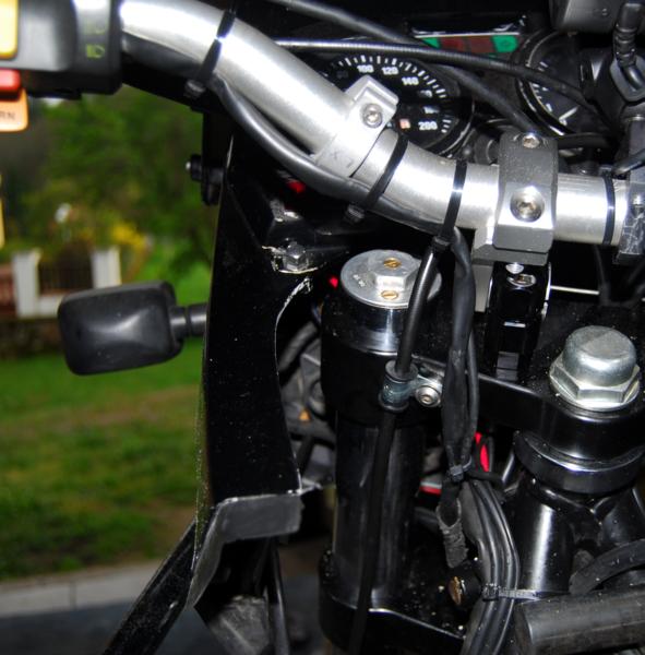

Got my brake parts today so its all a step nearer the first road test.
Went for a Venhill flexi all the way to the caliper. The tube is anchored to the leg by a couple of stainless clamps and "P" clips. Used a 75 degree banjo at the caliper end.
The line is anchored at the top triple with another "P" clip. Had to drill and tap the triple. This gives a good amount for the flex of the suspension.
