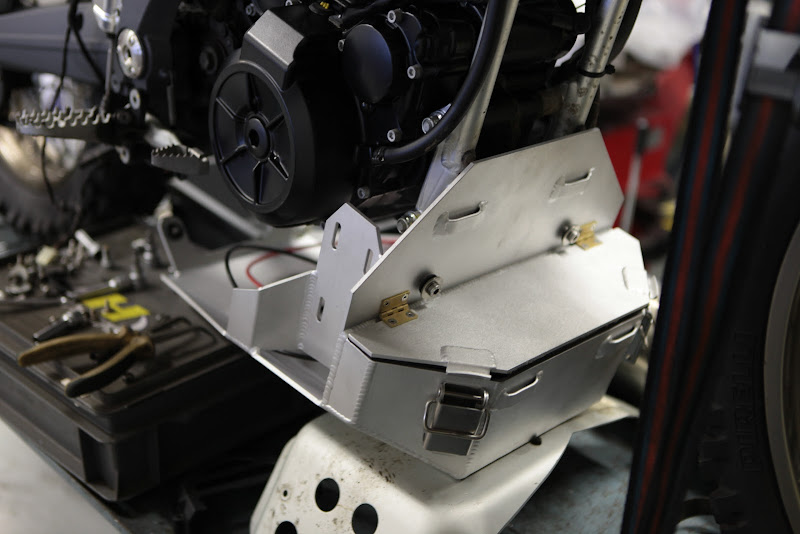

Not sure if I will move the battery or not, it is all wired to go though and is watertight.
Any advice on what to check, replace or attend to while I have it in pieces? The bike has done 2000miles.
