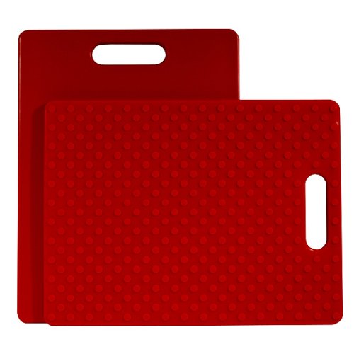

Red polypro step plate

Where did you get these "red" edge trimmings?
Where is your Tub brake?

Ah, yes, the red trim. This stuff is abundantly available, but Googling it is next to impossible. You just can't find it! Even if you go to the J.C. Whitney website (where I found it) and search for it, you can't find it! Unless you know what to call it. HERE IT IS (clicky)! $27 for a 20-ft roll. Also comes in blue, gray, green, brown, aqua, and off-white.
The brake is mounted on the inside of the wheel. You can see the rotor in the "car pusher" pic above. The caliper is mounted at about 2 o'clock if looking at the tub from the right side.

Dronie....one more asking,.. from whom did you get the redish GRP step platform material on the Tub and brake pedal?. Looks robust and could make an extended pad for the OEM pegs. My boots sole is only half on the OEM pegs due to having 2 master cylinders connected in tandem: one for the Pucher and one for the Tub. These 2 push my boot outwards.
That red gripper step material is pretty high tech stuff. I think it was developed by NASA for the space program. Actually, it's just a polypropylene cutting board with some kind of rubbery discs laminated to one side. Costs about $10 shipped for an 8x11" sheet from Amazon, $20 for an 11x14" sheet. Also available in green, blue, orange, yellow, gray and white. HERE'S A LINK.
